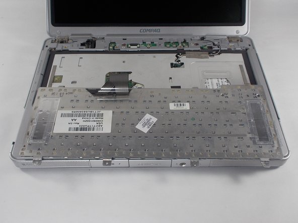

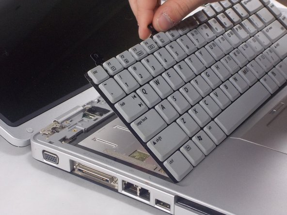

    • Remove the four 3mm Phillips #1 screws that secure the keyboard to the computer.
    • Swing the rear edge of the keyboard up and forward until it rests on the palm rest.
  8. Compaq Presario V2414NR Keyboard Replacement: crwdns2935265:08crwdnd2935265:01crwdnd2935265:01crwdne2935265:0
    • Use your fingernails or two plastic opening tools to push the white portion of the ZIF connector towards the hinge of the computer.
    • Remove the ribbon cable from the ZIF connector.
    • Remove the keyboard.
