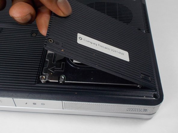

  3. Compaq Presario V2414NR Hard Drive Replacement, Hard Drive: crwdns2935265:03crwdnd2935265:01crwdnd2935265:02crwdne2935265:0 Compaq Presario V2414NR Hard Drive Replacement, Hard Drive: crwdns2935265:03crwdnd2935265:02crwdnd2935265:02crwdne2935265:0
    • Loosen the two 5mm Philips #1 screws that secure the hard drive cover to the computer.
    • These screws are captured to the cover panel.
    • Lift the left side of the cover and swing it to the right to remove it.

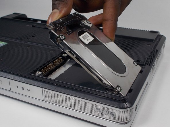

  4. Compaq Presario V2414NR Hard Drive Replacement: crwdns2935265:04crwdnd2935265:01crwdnd2935265:02crwdne2935265:0 Compaq Presario V2414NR Hard Drive Replacement: crwdns2935265:04crwdnd2935265:02crwdnd2935265:02crwdne2935265:0
    • Grasp the black Mylar tab on the hard drive frame and pull firmly straight up until the hard drive disconnects from the computer, and remove it.
    • When reassembling: First, align the two tabs on the hard drive with the slots in the chassis, then press down on the left edge of the hard drive to seat the contacts.
