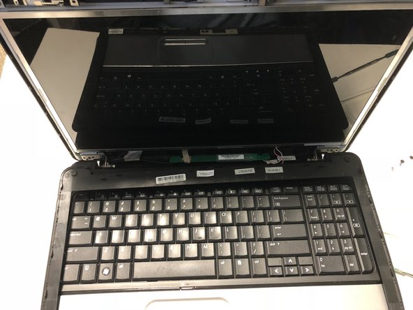

    • Start by making sure the CQ60 is powered down and that the disk drive is empty.
    • Flip the device over and remove the battery.
  2. Compaq Presario CQ60-211DX Display Assembly Replacement: crwdns2935265:02crwdnd2935265:01crwdnd2935265:02crwdne2935265:0 Compaq Presario CQ60-211DX Display Assembly Replacement: crwdns2935265:02crwdnd2935265:02crwdnd2935265:02crwdne2935265:0
    • Remove the rubber screw covers next to each of the two screen hinges using a metal spudger.
    • Unscrew the screws underneath the rubber cover using the blank Phillips-head screwdriver.
  3. Compaq Presario CQ60-211DX Display Assembly Replacement: crwdns2935265:03crwdnd2935265:01crwdnd2935265:02crwdne2935265:0 Compaq Presario CQ60-211DX Display Assembly Replacement: crwdns2935265:03crwdnd2935265:02crwdnd2935265:02crwdne2935265:0
    • Use the metal spudger to gently pry the plastic faceplate off the rest of the display.
  4. Compaq Presario CQ60-211DX Display Assembly Replacement: crwdns2935265:04crwdnd2935265:01crwdnd2935265:01crwdne2935265:0
    • Unscrew the two screws in the top corners to separate the frame holding the assembly from the plastic of the lid.
  5. Compaq Presario CQ60-211DX Display Assembly Replacement: crwdns2935265:05crwdnd2935265:01crwdnd2935265:01crwdne2935265:0
    • Disconnect the assembly from the chip located between the hinges by pulling the wires to the right.
  6. Compaq Presario CQ60-211DX Display Assembly Replacement: crwdns2935265:06crwdnd2935265:01crwdnd2935265:01crwdne2935265:0
    • Pull the frame forward, and then unscrew the three screws on each side.
  7. Compaq Presario CQ60-211DX Display Assembly Replacement: crwdns2935265:07crwdnd2935265:01crwdnd2935265:01crwdne2935265:0
    • Disconnect the ribbon cable on the back of the display by peeling back the tape and then pulling down on the cable.
