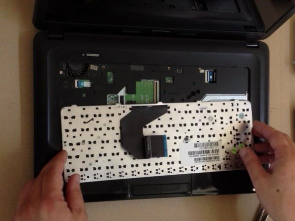

    • Remove the Battery.
    • Remove the RAM Memory Cover.
    • Under the cover you ca find one screw with keyboard symbol next to him. This screw is held the Keyboard.
  2. Compaq Presario CQ58 Keyboard Replacement: crwdns2935265:02crwdnd2935265:01crwdnd2935265:03crwdne2935265:0 Compaq Presario CQ58 Keyboard Replacement: crwdns2935265:02crwdnd2935265:02crwdnd2935265:03crwdne2935265:0 Compaq Presario CQ58 Keyboard Replacement: crwdns2935265:02crwdnd2935265:03crwdnd2935265:03crwdne2935265:0
    • The Keyboard is held by 5X locking clips.
  3. Compaq Presario CQ58 Keyboard Replacement: crwdns2935265:03crwdnd2935265:01crwdnd2935265:02crwdne2935265:0 Compaq Presario CQ58 Keyboard Replacement: crwdns2935265:03crwdnd2935265:02crwdnd2935265:02crwdne2935265:0
    • Disconnect the Keyboard Flex cable and install the new Keyboard.
    • Did you do it successfully?

Great guild on the Keyboard 5X locking clips . Was really having a time on getting the 1st one to pop this helped greatly!
