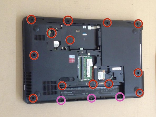

    • Switch-off the laptop and remove the battery.
    • Remove the memory cover.

    • Unscrew the screws on the bottom side of the laptop:
    • 13x M2.5x5.0
    • 3x M2.5x3.0
