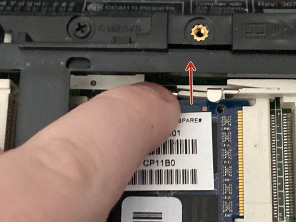

  4. Compaq Presario CQ57 RAM Replacement: crwdns2935265:04crwdnd2935265:01crwdnd2935265:03crwdne2935265:0 Compaq Presario CQ57 RAM Replacement: crwdns2935265:04crwdnd2935265:02crwdnd2935265:03crwdne2935265:0 Compaq Presario CQ57 RAM Replacement: crwdns2935265:04crwdnd2935265:03crwdnd2935265:03crwdne2935265:0
    • Slide these 2 thingys that hold the RAM.
    • The RAM should pop out.
  5. Compaq Presario CQ57 RAM Replacement, Take out the ram: crwdns2935265:05crwdnd2935265:01crwdnd2935265:02crwdne2935265:0 Compaq Presario CQ57 RAM Replacement, Take out the ram: crwdns2935265:05crwdnd2935265:02crwdnd2935265:02crwdne2935265:0
    • Take out the RAM.
