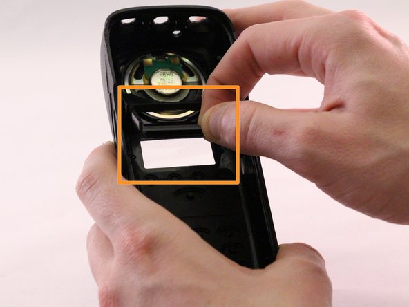

    • Locate the device's speaker inside the front panel of the exterior case.
    • Locate the display and speaker stabilizer.
    • Lift the stabilizer up from the bottom and pull the stabilizer out of case.

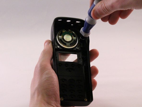

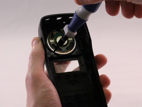

    • Locate the two 3.75mm screws holding the speaker to the exterior case.
    • Using a T15 Torx screwdriver, unscrew the 3.75mm screws.

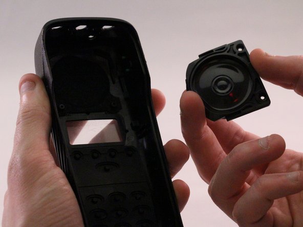

  7. ComNet Ericsson Panther 600P Speaker Replacement: crwdns2935265:07crwdnd2935265:01crwdnd2935265:02crwdne2935265:0 ComNet Ericsson Panther 600P Speaker Replacement: crwdns2935265:07crwdnd2935265:02crwdnd2935265:02crwdne2935265:0
    • Lift up on the bottom of the speaker to detach the speaker.
    • Pull the speaker out of the case.
