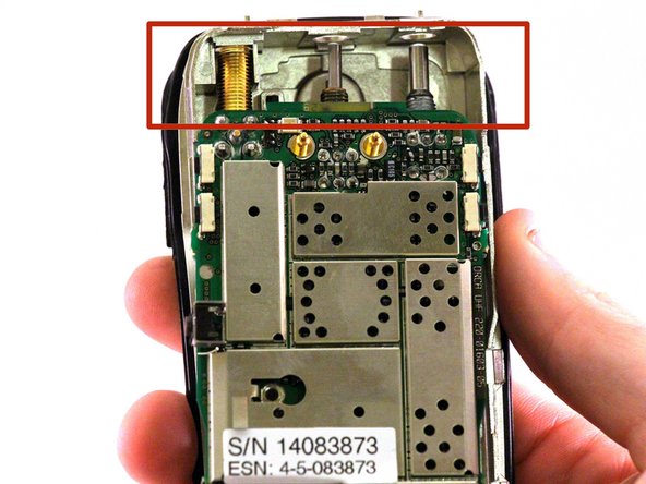

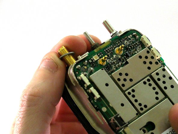

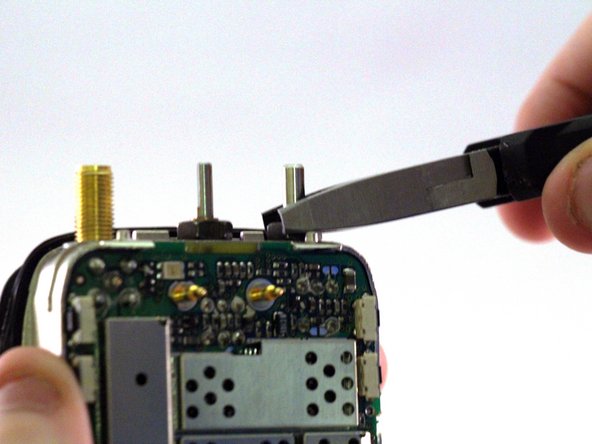

  8. ComNet Ericsson Panther 600P Motherboard Replacement, Antenna, Volume, Channel Nuts: crwdns2935265:08crwdnd2935265:01crwdnd2935265:03crwdne2935265:0 ComNet Ericsson Panther 600P Motherboard Replacement, Antenna, Volume, Channel Nuts: crwdns2935265:08crwdnd2935265:02crwdnd2935265:03crwdne2935265:0 ComNet Ericsson Panther 600P Motherboard Replacement, Antenna, Volume, Channel Nuts: crwdns2935265:08crwdnd2935265:03crwdnd2935265:03crwdne2935265:0
    • Remove the rubber O-rings from the antenna jack, volume switch, and channel switch.
    • Once the rubber O-rings have been removed, use small needle nose pliers to unscrew the nuts on the antenna jack, volume switch, and channel switch.
    • There are washers underneath the nuts on the antenna jack, volume switch, and channel switch. Set these washers aside.

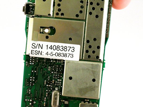

  9. ComNet Ericsson Panther 600P Motherboard Replacement: crwdns2935265:09crwdnd2935265:01crwdnd2935265:01crwdne2935265:0
    • Using a T15 Torx screwdriver, unscrew the 3.8mm screw from the case.
  10. ComNet Ericsson Panther 600P Motherboard Replacement, Internal Case - Back: crwdns2935265:010crwdnd2935265:01crwdnd2935265:03crwdne2935265:0 ComNet Ericsson Panther 600P Motherboard Replacement, Internal Case - Back: crwdns2935265:010crwdnd2935265:02crwdnd2935265:03crwdne2935265:0 ComNet Ericsson Panther 600P Motherboard Replacement, Internal Case - Back: crwdns2935265:010crwdnd2935265:03crwdnd2935265:03crwdne2935265:0
    • Using any convenient hand-placement, pull the motherboard away from the case.
    • The antenna jack, volume dial, and channel dial are attached to the motherboard. Be sure to pull the motherboard downward so they clear their respective slots in the case.
    • Lift the motherboard completely free of the case.
