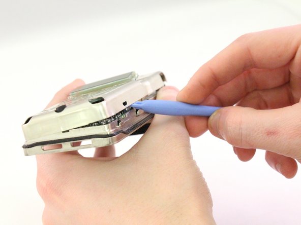

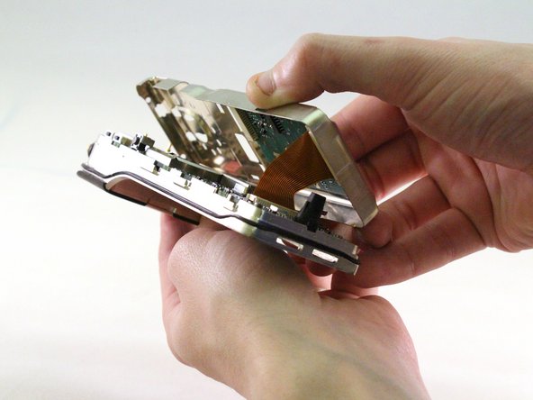

  5. ComNet Ericsson Panther 600P Display Replacement, Front Case - Internal: crwdns2935265:05crwdnd2935265:01crwdnd2935265:03crwdne2935265:0 ComNet Ericsson Panther 600P Display Replacement, Front Case - Internal: crwdns2935265:05crwdnd2935265:02crwdnd2935265:03crwdne2935265:0 ComNet Ericsson Panther 600P Display Replacement, Front Case - Internal: crwdns2935265:05crwdnd2935265:03crwdnd2935265:03crwdne2935265:0
    • Using the plastic opening tool, pry the case apart.

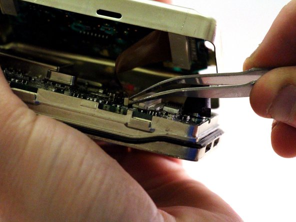

  6. ComNet Ericsson Panther 600P Display Replacement, Ribbon: crwdns2935265:06crwdnd2935265:01crwdnd2935265:02crwdne2935265:0 ComNet Ericsson Panther 600P Display Replacement, Ribbon: crwdns2935265:06crwdnd2935265:02crwdnd2935265:02crwdne2935265:0
    • The keypad chip is attached to the motherboard by a ribbon.
    • Pull ribbon with tweezers to detach from back panel.

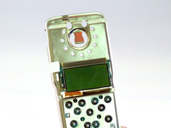

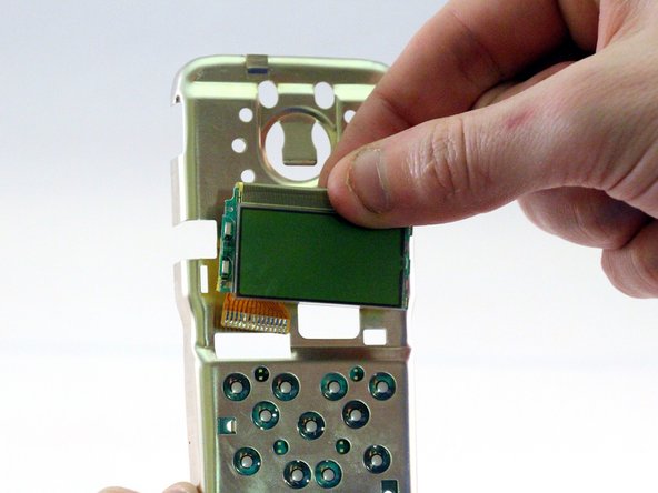

  7. ComNet Ericsson Panther 600P Display Replacement, Screen: crwdns2935265:07crwdnd2935265:01crwdnd2935265:03crwdne2935265:0 ComNet Ericsson Panther 600P Display Replacement, Screen: crwdns2935265:07crwdnd2935265:02crwdnd2935265:03crwdne2935265:0 ComNet Ericsson Panther 600P Display Replacement, Screen: crwdns2935265:07crwdnd2935265:03crwdnd2935265:03crwdne2935265:0
    • Screen will be attached by a ribbon.
    • Pull screen up and away from motherboard to detach.
