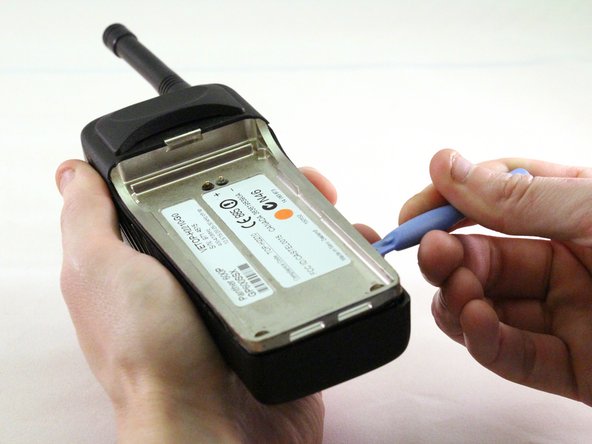

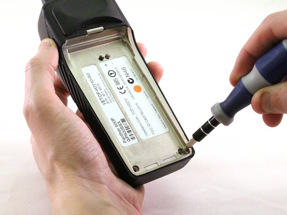

  4. ComNet Ericsson Panther 600P Buttons Replacement, Exterior Case: crwdns2935265:04crwdnd2935265:01crwdnd2935265:03crwdne2935265:0 ComNet Ericsson Panther 600P Buttons Replacement, Exterior Case: crwdns2935265:04crwdnd2935265:02crwdnd2935265:03crwdne2935265:0 ComNet Ericsson Panther 600P Buttons Replacement, Exterior Case: crwdns2935265:04crwdnd2935265:03crwdnd2935265:03crwdne2935265:0
    • Using a T15 Torx screwdriver, unscrew the two screws.
    • Using a plastic opening tool, pry the internal case from the external case.

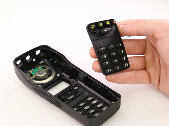

  5. ComNet Ericsson Panther 600P Buttons Replacement, Remove Buttons: crwdns2935265:05crwdnd2935265:01crwdnd2935265:02crwdne2935265:0 ComNet Ericsson Panther 600P Buttons Replacement, Remove Buttons: crwdns2935265:05crwdnd2935265:02crwdnd2935265:02crwdne2935265:0
    • Grip the corner of the button pad and gently peal it away from the faceplate.
    • Clean off any sticky residue and/or replace the buttons.
