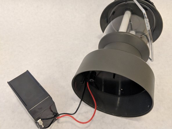

    • Carefully turn the lantern upside down.
    • Remove the three 1.2 mm Phillips #0 screws from the base of the lantern.
  2. Coleman Rechargeable Fluorescent Twin Tube Lantern Power Switch Replacement: crwdns2935265:02crwdnd2935265:01crwdnd2935265:01crwdne2935265:0
    • Carefully pull the bottom of the lantern to remove the base from the device.
  3. Coleman Rechargeable Fluorescent Twin Tube Lantern Power Switch Replacement: crwdns2935265:03crwdnd2935265:01crwdnd2935265:02crwdne2935265:0 Coleman Rechargeable Fluorescent Twin Tube Lantern Power Switch Replacement: crwdns2935265:03crwdnd2935265:02crwdnd2935265:02crwdne2935265:0
    • Gently pull the battery out of the slot and away from the base.
    • The battery may be held into place by adhesive strips.
  4. Coleman Rechargeable Fluorescent Twin Tube Lantern Power Switch Replacement: crwdns2935265:04crwdnd2935265:01crwdnd2935265:03crwdne2935265:0 Coleman Rechargeable Fluorescent Twin Tube Lantern Power Switch Replacement: crwdns2935265:04crwdnd2935265:02crwdnd2935265:03crwdne2935265:0 Coleman Rechargeable Fluorescent Twin Tube Lantern Power Switch Replacement: crwdns2935265:04crwdnd2935265:03crwdnd2935265:03crwdne2935265:0
    • Carefully detach the negative wire from the battery terminal first.
    • Next, detach the positive wire from the battery terminal.

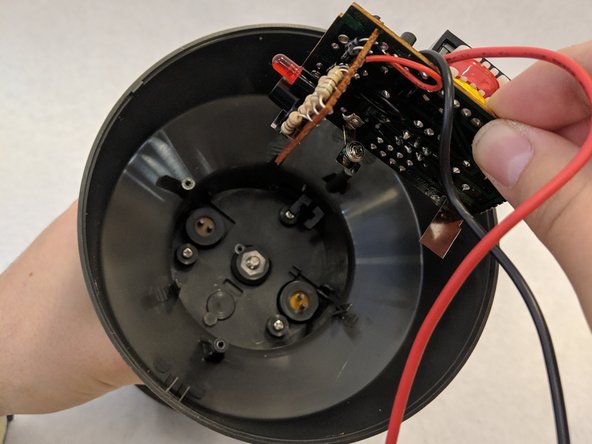

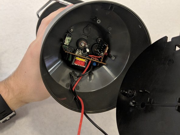

  5. Coleman Rechargeable Fluorescent Twin Tube Lantern Power Switch Replacement, Main Power Board: crwdns2935265:05crwdnd2935265:01crwdnd2935265:02crwdne2935265:0 Coleman Rechargeable Fluorescent Twin Tube Lantern Power Switch Replacement, Main Power Board: crwdns2935265:05crwdnd2935265:02crwdnd2935265:02crwdne2935265:0
    • Remove the single 1.2 mm Phillips #1 screw on the bottom of the lantern.
    • Remove the plastic barrier.

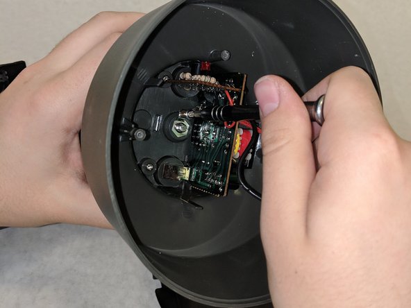

  6. Coleman Rechargeable Fluorescent Twin Tube Lantern Power Switch Replacement: crwdns2935265:06crwdnd2935265:01crwdnd2935265:02crwdne2935265:0 Coleman Rechargeable Fluorescent Twin Tube Lantern Power Switch Replacement: crwdns2935265:06crwdnd2935265:02crwdnd2935265:02crwdne2935265:0
    • Unscrew the single 1.2 mm Phillips #1 screw holding the motherboard to the plastic lantern housing.

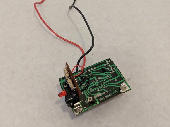

  7. Coleman Rechargeable Fluorescent Twin Tube Lantern Power Switch Replacement: crwdns2935265:07crwdnd2935265:01crwdnd2935265:03crwdne2935265:0 Coleman Rechargeable Fluorescent Twin Tube Lantern Power Switch Replacement: crwdns2935265:07crwdnd2935265:02crwdnd2935265:03crwdne2935265:0 Coleman Rechargeable Fluorescent Twin Tube Lantern Power Switch Replacement: crwdns2935265:07crwdnd2935265:03crwdnd2935265:03crwdne2935265:0
    • Gently grab the main board by the exposed PCB.
    • Pull the main board straight out of the housing.

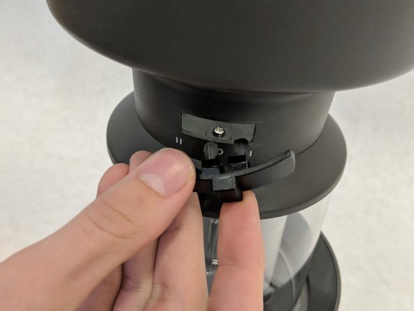

  8. Coleman Rechargeable Fluorescent Twin Tube Lantern Power Switch Replacement, Lantern Power Switch: crwdns2935265:08crwdnd2935265:01crwdnd2935265:02crwdne2935265:0 Coleman Rechargeable Fluorescent Twin Tube Lantern Power Switch Replacement, Lantern Power Switch: crwdns2935265:08crwdnd2935265:02crwdnd2935265:02crwdne2935265:0
    • Remove the switch by pushing down on the ends while simultaneously pulling it out of the slot.
    • When removing the switch, make sure to depress the inner clips when removing from the device. Be careful, do not force the switch from the base of the lantern.
