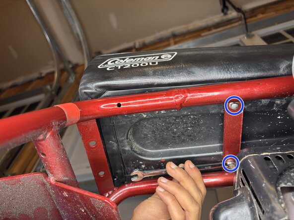

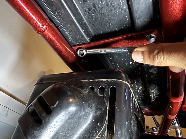

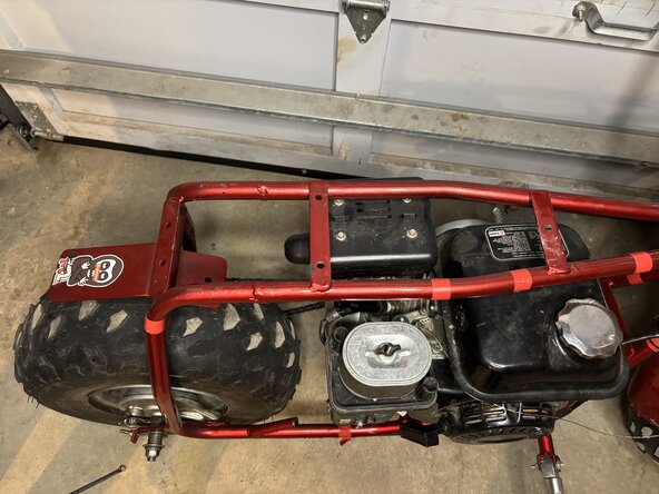

    • Switch OFF the fuel valve and place bike on a leveled surface before starting.
    • We should remove seat for better access.
    • There are two 8mm bolts holding the seat down to the frame (Picture 2)
    • Remove, them and pull up and the seat should just come off, making it much easier to access components of the throttle assembly
    • Step 1 Completed

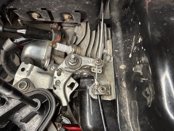

  2. Coleman CT200U-AB Mini Bike Throttle Assembly Replacement, Spark plug Wire (MUST): crwdns2935265:02crwdnd2935265:01crwdnd2935265:01crwdne2935265:0
    • Once the seat is off you can see the spark plug wire.
    • Disconnect the spark plug wire as a safety precaution. This will disable the ignition. Make sure to grab the wire while also holding the head of the wire and give a gentle pull to separate the spark plug from the wire
    • Step 2 Completed

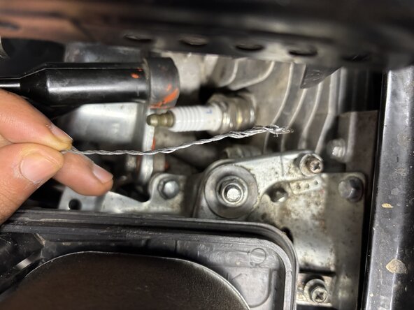

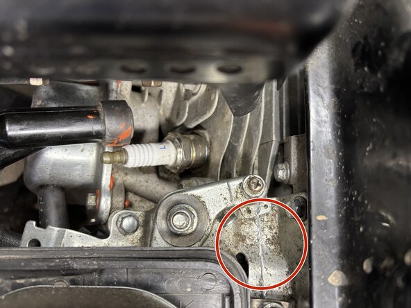

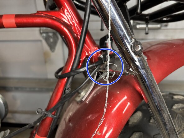

  3. Coleman CT200U-AB Mini Bike Throttle Assembly Replacement, Inspection Of Throttle: crwdns2935265:03crwdnd2935265:01crwdnd2935265:02crwdne2935265:0 Coleman CT200U-AB Mini Bike Throttle Assembly Replacement, Inspection Of Throttle: crwdns2935265:03crwdnd2935265:02crwdnd2935265:02crwdne2935265:0
    • Inspect the Throttle Assembly Check for visible damage to the throttle cable, grip, and housing. Look for frayed cables or sticking in the throttle twist mechanism.
    • As you can probably see this cable is pretty frayed up. So it must be replaced

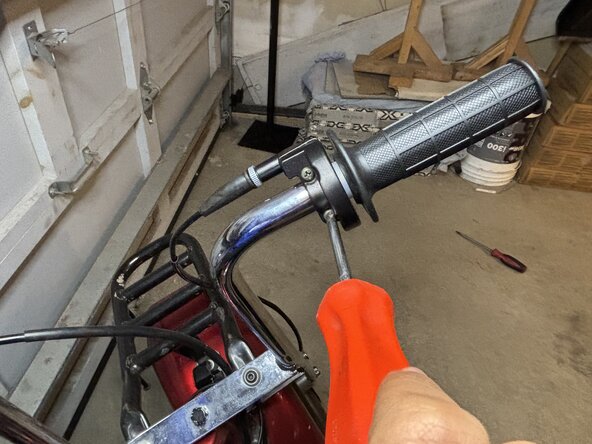

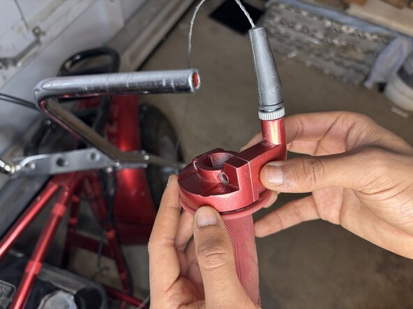

  4. Coleman CT200U-AB Mini Bike Throttle Assembly Replacement, Removing of grip: crwdns2935265:04crwdnd2935265:01crwdnd2935265:03crwdne2935265:0 Coleman CT200U-AB Mini Bike Throttle Assembly Replacement, Removing of grip: crwdns2935265:04crwdnd2935265:02crwdnd2935265:03crwdne2935265:0 Coleman CT200U-AB Mini Bike Throttle Assembly Replacement, Removing of grip: crwdns2935265:04crwdnd2935265:03crwdnd2935265:03crwdne2935265:0
    • Remove the Screw in Photo 1 with the Philips head screwdriver.
    • Slide the rubber grp off
    • Take off the throttle clamp to expose the throttle cable sheath.
    • Step 4 Completed

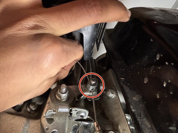

  5. Coleman CT200U-AB Mini Bike Throttle Assembly Replacement, Disconnecting cable: crwdns2935265:05crwdnd2935265:01crwdnd2935265:03crwdne2935265:0 Coleman CT200U-AB Mini Bike Throttle Assembly Replacement, Disconnecting cable: crwdns2935265:05crwdnd2935265:02crwdnd2935265:03crwdne2935265:0 Coleman CT200U-AB Mini Bike Throttle Assembly Replacement, Disconnecting cable: crwdns2935265:05crwdnd2935265:03crwdnd2935265:03crwdne2935265:0
    • From the throttle assembly located on the engine remove the nut screw holding the cable in place (photo 1)
    • Closer look at photo2
    • Use the screwdriver to take off.
    • Step 5 completed

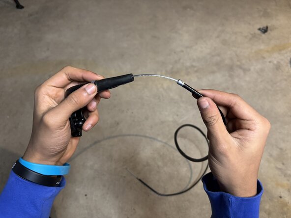

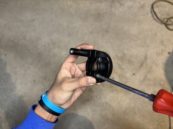

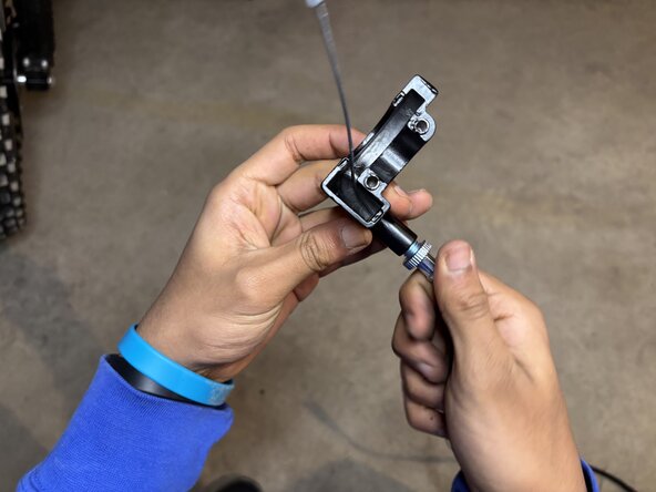

  6. Coleman CT200U-AB Mini Bike Throttle Assembly Replacement, Throttle assembly Part 1: crwdns2935265:06crwdnd2935265:01crwdnd2935265:03crwdne2935265:0 Coleman CT200U-AB Mini Bike Throttle Assembly Replacement, Throttle assembly Part 1: crwdns2935265:06crwdnd2935265:02crwdnd2935265:03crwdne2935265:0 Coleman CT200U-AB Mini Bike Throttle Assembly Replacement, Throttle assembly Part 1: crwdns2935265:06crwdnd2935265:03crwdnd2935265:03crwdne2935265:0

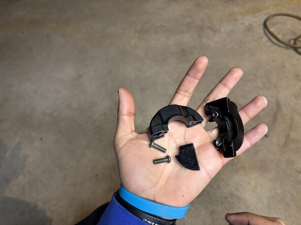

    • Lay out your new throttle kit in front of you. Check to make sure you have a grip, throttle cable and clamp.
    • Take apart throttle clamp with screwdriver.(Picture 2 & 3)

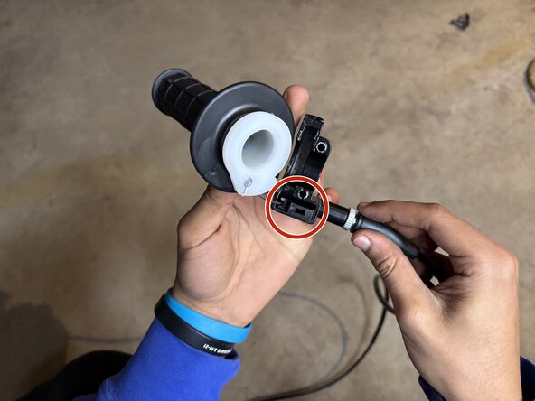

  7. Coleman CT200U-AB Mini Bike Throttle Assembly Replacement, Throttle assembly Part 2: crwdns2935265:07crwdnd2935265:01crwdnd2935265:03crwdne2935265:0 Coleman CT200U-AB Mini Bike Throttle Assembly Replacement, Throttle assembly Part 2: crwdns2935265:07crwdnd2935265:02crwdnd2935265:03crwdne2935265:0 Coleman CT200U-AB Mini Bike Throttle Assembly Replacement, Throttle assembly Part 2: crwdns2935265:07crwdnd2935265:03crwdnd2935265:03crwdne2935265:0
    • Install the new wire onto the new throttle.
    • First insert the ferrule into its recess.
    • Step 7 completed

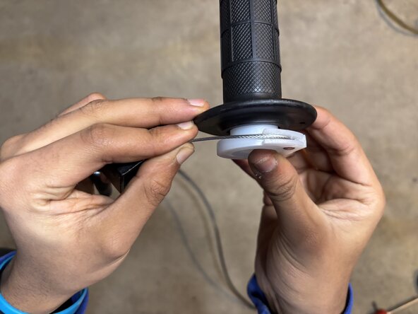

  8. Coleman CT200U-AB Mini Bike Throttle Assembly Replacement, Seat Cable in Throttle Housing: crwdns2935265:08crwdnd2935265:01crwdnd2935265:03crwdne2935265:0 Coleman CT200U-AB Mini Bike Throttle Assembly Replacement, Seat Cable in Throttle Housing: crwdns2935265:08crwdnd2935265:02crwdnd2935265:03crwdne2935265:0 Coleman CT200U-AB Mini Bike Throttle Assembly Replacement, Seat Cable in Throttle Housing: crwdns2935265:08crwdnd2935265:03crwdnd2935265:03crwdne2935265:0
    • Insert the ferrule into its recess. (Pic 1)
    • Hook the barrel into the grip drum. (Pic 2)
    • Check that the cable rides in the molded channel.(pic 3)
    • Step 8 completed

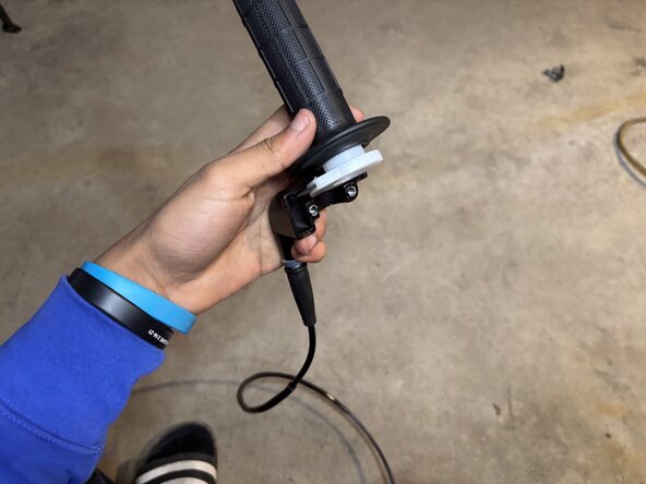

  9. Coleman CT200U-AB Mini Bike Throttle Assembly Replacement, Reassemble Housing: crwdns2935265:09crwdnd2935265:01crwdnd2935265:03crwdne2935265:0 Coleman CT200U-AB Mini Bike Throttle Assembly Replacement, Reassemble Housing: crwdns2935265:09crwdnd2935265:02crwdnd2935265:03crwdne2935265:0 Coleman CT200U-AB Mini Bike Throttle Assembly Replacement, Reassemble Housing: crwdns2935265:09crwdnd2935265:03crwdnd2935265:03crwdne2935265:0

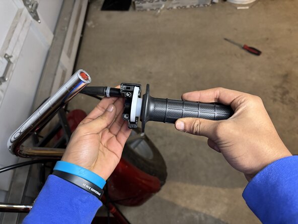

    • Prepare the grip and throttle for installation on the handlebars. (Pic 1)
    • Apply a drop of thread‑locker to each bolt. Clamp the two housing halves together (Pic 2)
    • Slide the grip on (pic 3)
    • Step 9 Completed
  10. Coleman CT200U-AB Mini Bike Throttle Assembly Replacement, Install grip: crwdns2935265:010crwdnd2935265:01crwdnd2935265:02crwdne2935265:0 Coleman CT200U-AB Mini Bike Throttle Assembly Replacement, Install grip: crwdns2935265:010crwdnd2935265:02crwdnd2935265:02crwdne2935265:0
    • Secure the throttle assembly onto the handlebars.
    • Slide the grip on; tighten the set screw. (Pic 2)
    • Step 10 completed

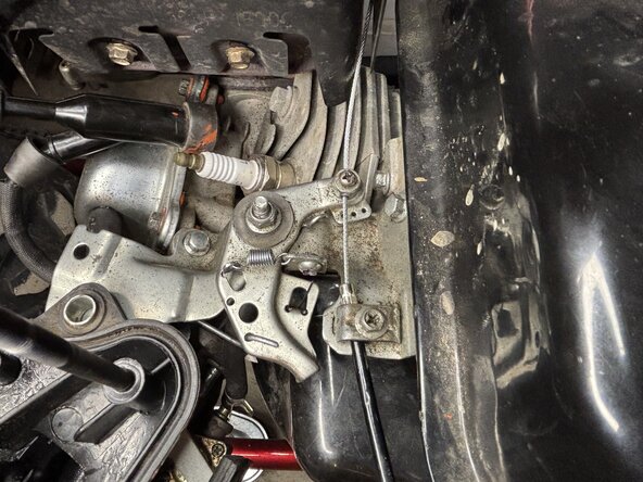

  11. Coleman CT200U-AB Mini Bike Throttle Assembly Replacement, Attaching Throttle cable: crwdns2935265:011crwdnd2935265:01crwdnd2935265:03crwdne2935265:0 Coleman CT200U-AB Mini Bike Throttle Assembly Replacement, Attaching Throttle cable: crwdns2935265:011crwdnd2935265:02crwdnd2935265:03crwdne2935265:0 Coleman CT200U-AB Mini Bike Throttle Assembly Replacement, Attaching Throttle cable: crwdns2935265:011crwdnd2935265:03crwdnd2935265:03crwdne2935265:0

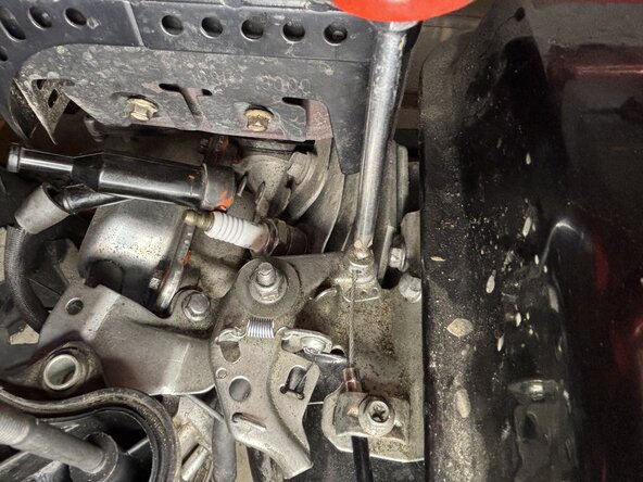

    • Attach the cable sleeve to the throttle assembly on the engine.
    • From the throttle assembly located on the engine place the throttle cable then tighten the screws.( Pic 2 and 3)
    • Reverse of step 4
    • Step 11 completed
  12. Coleman CT200U-AB Mini Bike Throttle Assembly Replacement, Adjust Throttle Free Play: crwdns2935265:012crwdnd2935265:01crwdnd2935265:03crwdne2935265:0 Coleman CT200U-AB Mini Bike Throttle Assembly Replacement, Adjust Throttle Free Play: crwdns2935265:012crwdnd2935265:02crwdnd2935265:03crwdne2935265:0 Coleman CT200U-AB Mini Bike Throttle Assembly Replacement, Adjust Throttle Free Play: crwdns2935265:012crwdnd2935265:03crwdnd2935265:03crwdne2935265:0
    • Adjust the Throttle Tension Ensure the throttle snaps back properly when released.
    • Adjust the cable tension if necessary, using the adjustment screw near the carburetor. Refer back to the previous step if necessary.(Pic 2 & 3)
