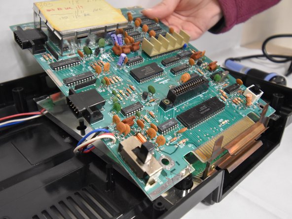

    • Using a Phillips #1 screwdriver, remove the two 15mm screws on the motherboard.
    • Pull the entire motherboard towards the back of the system and carefully lift the entire motherboard.
  5. ColecoVision Power Switch Replacement: crwdns2935265:05crwdnd2935265:01crwdnd2935265:01crwdne2935265:0
    • Flip the motherboard over.
    • Using a soldering iron, carefully desolder the power switch from the motherboard.
    • Refer to this soldering technique guide for reference.
  6. ColecoVision Power Switch Replacement: crwdns2935265:06crwdnd2935265:01crwdnd2935265:01crwdne2935265:0
    • Wait for power switch to cool down.
    • Turn the motherboard over upright.
    • Carefully lift up the power switch to completely remove it from the motherboard.
