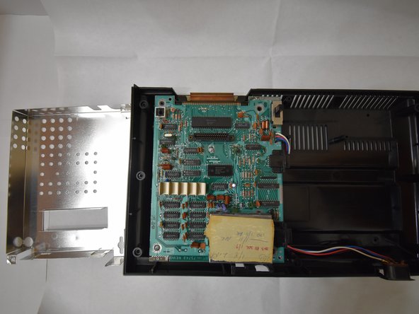

    • Start by laying the console face down.
    • Remove the eight 15mm Phillips #1 screws from the bottom of the device.
  2. ColecoVision Motherboard Replacement: crwdns2935265:02crwdnd2935265:01crwdnd2935265:02crwdne2935265:0 ColecoVision Motherboard Replacement: crwdns2935265:02crwdnd2935265:02crwdnd2935265:02crwdne2935265:0
    • Flip the console back over.
    • Lift the front panel off. I would reccomended using a metal spudger along the rim of the top to safely remove it and set it aside.
  3. ColecoVision Motherboard Replacement: crwdns2935265:03crwdnd2935265:01crwdnd2935265:02crwdne2935265:0 ColecoVision Motherboard Replacement: crwdns2935265:03crwdnd2935265:02crwdnd2935265:02crwdne2935265:0
    • Remove the two 15mm Phillips #1 screws holding the casing in place.
    • Carefully lift the casing from the motherboard.
  4. ColecoVision Motherboard Replacement: crwdns2935265:04crwdnd2935265:01crwdnd2935265:01crwdne2935265:0
    • Remove the center Phillips #1 screw near the cartridge slot.
    • Remove the second Phillips #1 screw near the RAM chips.
    • Carefully lift and remove the motherboard.
