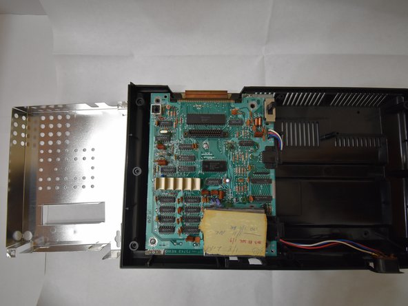

    3. ColecoVision Controller Port Replacement: crwdns2935265:03crwdnd2935265:01crwdnd2935265:02crwdne2935265:0 ColecoVision Controller Port Replacement: crwdns2935265:03crwdnd2935265:02crwdnd2935265:02crwdne2935265:0
      • Remove the two 15mm screws holding the casing in place using the Phillips #1 screwdriver.
      • Remove the casing and put it to the side.
    4. ColecoVision Controller Port Replacement: crwdns2935265:04crwdnd2935265:01crwdnd2935265:02crwdne2935265:0 ColecoVision Controller Port Replacement: crwdns2935265:04crwdnd2935265:02crwdnd2935265:02crwdne2935265:0
      • Remove the two 15mm screws on the motherboard with a Phillips #1 screwdriver.
      • Pull the entire motherboard towards the back of the system and carefully lift the entire motherboard.

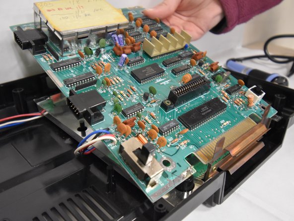

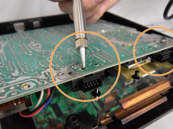

    5. ColecoVision Controller Port Replacement: crwdns2935265:05crwdnd2935265:01crwdnd2935265:03crwdne2935265:0 ColecoVision Controller Port Replacement: crwdns2935265:05crwdnd2935265:02crwdnd2935265:03crwdne2935265:0 ColecoVision Controller Port Replacement: crwdns2935265:05crwdnd2935265:03crwdnd2935265:03crwdne2935265:0
      • Flip the motherboard over and locate the two controller ports.
      • Using a soldering iron, desolder the controller ports.
      • Refer to this soldering technique guide for reference.
      • After waiting for controller ports to cool down, flip motherboard back over and carefully lift controller ports to remove.
