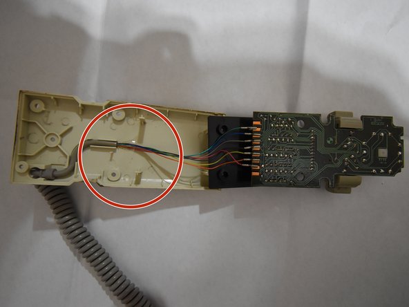

  4. ColecoVision Controller Circuit Board Replacement: crwdns2935265:04crwdnd2935265:01crwdnd2935265:02crwdne2935265:0 ColecoVision Controller Circuit Board Replacement: crwdns2935265:04crwdnd2935265:02crwdnd2935265:02crwdne2935265:0
    • Remove the tape and wiring holding the wires in place.
    • Carefully lift the circuit board out of the controller.
