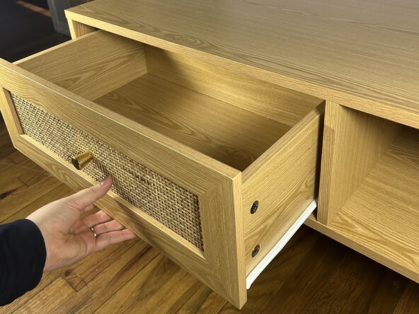

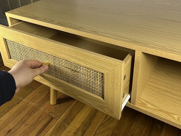

    • Make sure to empty the drawer completely before starting the replacement process.
  2. Coffee Table Metal Drawer Slides Replacement: crwdns2935265:02crwdnd2935265:01crwdnd2935265:03crwdne2935265:0 Coffee Table Metal Drawer Slides Replacement: crwdns2935265:02crwdnd2935265:02crwdnd2935265:03crwdne2935265:0 Coffee Table Metal Drawer Slides Replacement: crwdns2935265:02crwdnd2935265:03crwdnd2935265:03crwdne2935265:0

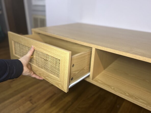

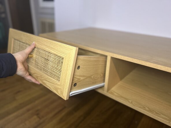

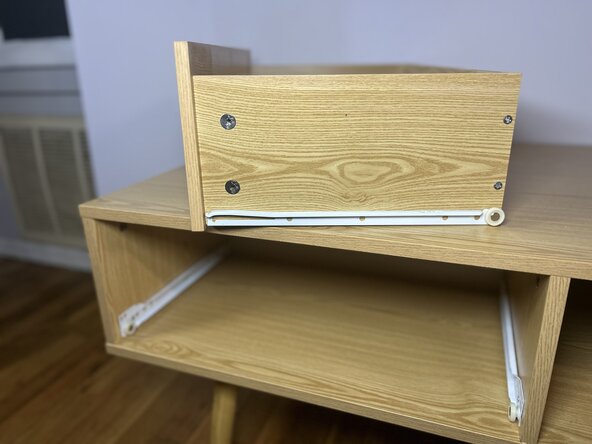

    • Remove the drawer carefully by pulling it out and slowly lifting it upwards until it is out.
  3. Coffee Table Metal Drawer Slides Replacement: crwdns2935265:03crwdnd2935265:01crwdnd2935265:02crwdne2935265:0 Coffee Table Metal Drawer Slides Replacement: crwdns2935265:03crwdnd2935265:02crwdnd2935265:02crwdne2935265:0

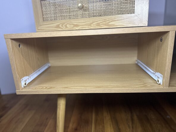

    • The drawer and drawer insertion should now look like this when the drawer is out completely.

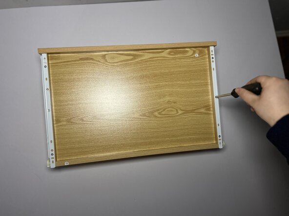

  4. Coffee Table Metal Drawer Slides Replacement: crwdns2935265:04crwdnd2935265:01crwdnd2935265:02crwdne2935265:0 Coffee Table Metal Drawer Slides Replacement: crwdns2935265:04crwdnd2935265:02crwdnd2935265:02crwdne2935265:0

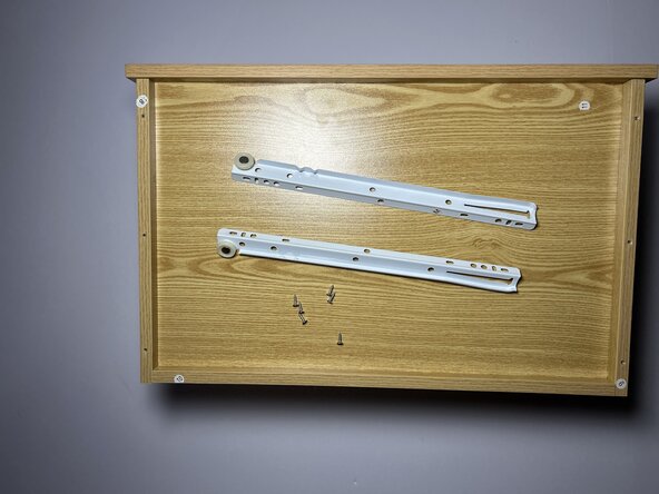

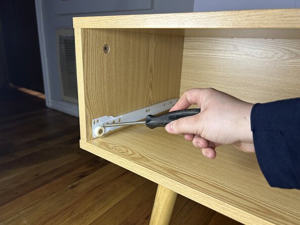

    • Remove the old gliders by taking the screwdriver and turning it counterclockwise (to the left) until the screw is completely out.
    • Make sure to take out all of the screws on the old gliders before proceeding to the next step.
    • The drill can be used instead of the screwdriver if wanted.
  5. Coffee Table Metal Drawer Slides Replacement: crwdns2935265:05crwdnd2935265:01crwdnd2935265:02crwdne2935265:0 Coffee Table Metal Drawer Slides Replacement: crwdns2935265:05crwdnd2935265:02crwdnd2935265:02crwdne2935265:0

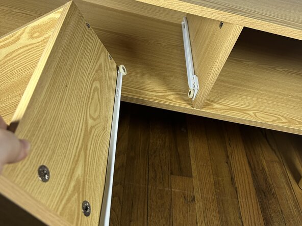

    • This is what the old drawer slides will look like when taken off completely.

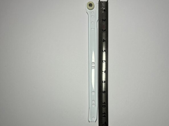

  6. Coffee Table Metal Drawer Slides Replacement: crwdns2935265:06crwdnd2935265:01crwdnd2935265:02crwdne2935265:0 Coffee Table Metal Drawer Slides Replacement: crwdns2935265:06crwdnd2935265:02crwdnd2935265:02crwdne2935265:0

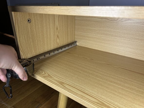

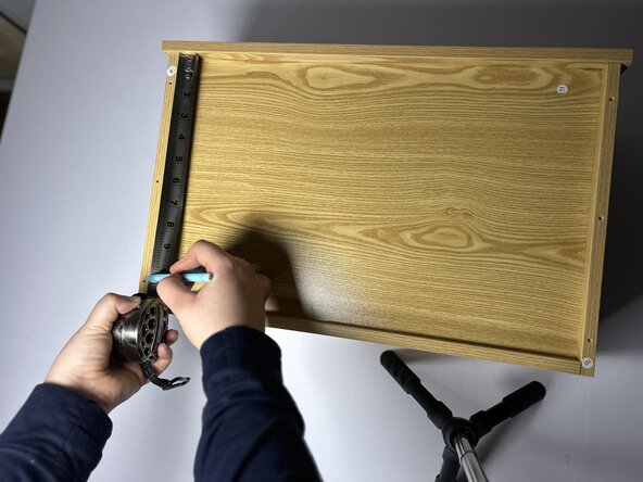

    • Measure the new drawer slides.
  7. Coffee Table Metal Drawer Slides Replacement: crwdns2935265:07crwdnd2935265:01crwdnd2935265:02crwdne2935265:0 Coffee Table Metal Drawer Slides Replacement: crwdns2935265:07crwdnd2935265:02crwdnd2935265:02crwdne2935265:0
    • Measure the drawer and the drawer insertion and make sure that the new drawer slides will fit before proceeding to the next step.
  8. Coffee Table Metal Drawer Slides Replacement: crwdns2935265:08crwdnd2935265:01crwdnd2935265:02crwdne2935265:0 Coffee Table Metal Drawer Slides Replacement: crwdns2935265:08crwdnd2935265:02crwdnd2935265:02crwdne2935265:0
    • If applicable, make new markings with the pencil if there needs to be new holes made for the new drawer slides.
    • The drill needs to be used if making new holes for the drawer slides.

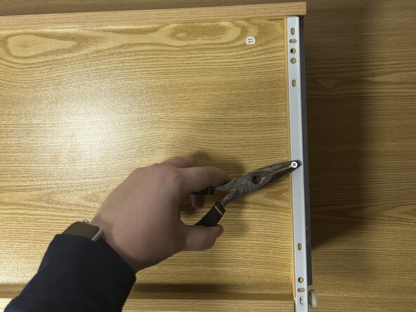

  10. Coffee Table Metal Drawer Slides Replacement: crwdns2935265:010crwdnd2935265:01crwdnd2935265:02crwdne2935265:0 Coffee Table Metal Drawer Slides Replacement: crwdns2935265:010crwdnd2935265:02crwdnd2935265:02crwdne2935265:0
    • If applicable, take the pliers and use them to help place the screw in place for screwing.
    • This step is optional.

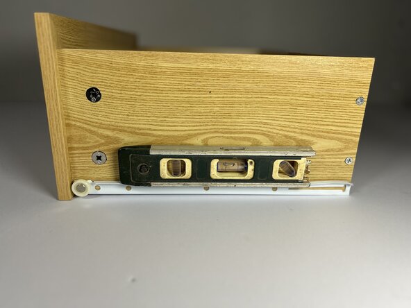

    • Use the level and make sure the drawer slides are level before proceeding to the next step.
  12. Coffee Table Metal Drawer Slides Replacement: crwdns2935265:012crwdnd2935265:01crwdnd2935265:03crwdne2935265:0 Coffee Table Metal Drawer Slides Replacement: crwdns2935265:012crwdnd2935265:02crwdnd2935265:03crwdne2935265:0 Coffee Table Metal Drawer Slides Replacement: crwdns2935265:012crwdnd2935265:03crwdnd2935265:03crwdne2935265:0
    • The new drawer slides will look like this when put on completely.
    • The drawer slides on the drawer itself should have the wheels placed on the back.
    • The drawer slides in the drawer insertion should have the wheels placed in the front.
