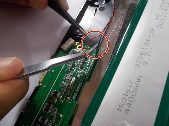

  3. Coby Kyros MID9042 Speakers Replacement: crwdns2935265:03crwdnd2935265:01crwdnd2935265:02crwdne2935265:0 Coby Kyros MID9042 Speakers Replacement: crwdns2935265:03crwdnd2935265:02crwdnd2935265:02crwdne2935265:0
    • Desolder the red and black speaker wires from the circuit board. How To Solder and Desolder Connections
    • Gently remove the speakers from the tablet.
    • When replacing the speaker, remember the red wire connects to positive and the black wire connects to negative.
