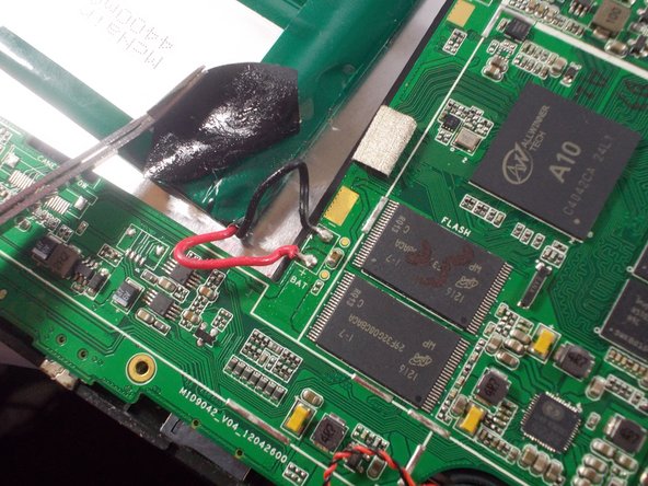

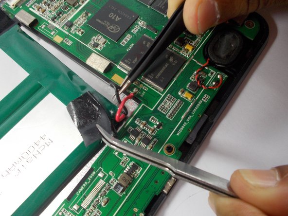

  3. Coby Kyros MID9042 Battery Replacement: crwdns2935265:03crwdnd2935265:01crwdnd2935265:03crwdne2935265:0 Coby Kyros MID9042 Battery Replacement: crwdns2935265:03crwdnd2935265:02crwdnd2935265:03crwdne2935265:0 Coby Kyros MID9042 Battery Replacement: crwdns2935265:03crwdnd2935265:03crwdnd2935265:03crwdne2935265:0
    • With the soldering iron, desolder the red and black battery wires from the circuit board.
    • Use the tweezers to connect the red wire to the positive and the black wire to the negative.
