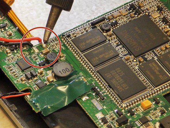

    • With the speakers now free from the back cover trace their wires back to the area where they connect to the motherboard.
  5. Coby Kyros MID7024 Speakers Replacement: crwdns2935265:05crwdnd2935265:01crwdnd2935265:02crwdne2935265:0 Coby Kyros MID7024 Speakers Replacement: crwdns2935265:05crwdnd2935265:02crwdnd2935265:02crwdne2935265:0
    • Use a soldering gun to remove the positive and negative wires connecting the battery to the motherboard.
    • Follow the guide on soldering to assist you in removing the battery.

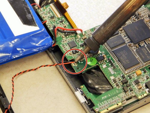

  6. Coby Kyros MID7024 Speakers Replacement: crwdns2935265:06crwdnd2935265:01crwdnd2935265:02crwdne2935265:0 Coby Kyros MID7024 Speakers Replacement: crwdns2935265:06crwdnd2935265:02crwdnd2935265:02crwdne2935265:0
    • To completely remove the speakers from the device use a soldering iron to unsolder the connection points located at the end of each wire.
    • Follow this guide on soldering to help you with unsoldering the wire from the motherboard.
