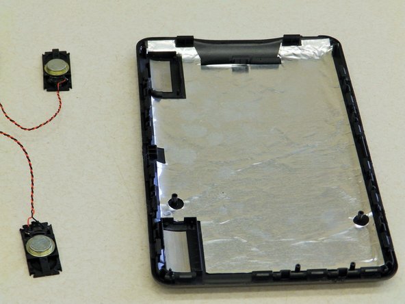

    • Once the back cover is free from the body of the device, open both sides like a book, placing them flat on the table as shown. Be sure to pay attention to the speaker wires that hold the two pieces together.

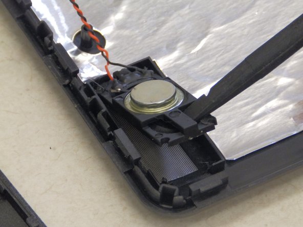

    • This step is only necessary if you intend to repair or replace the back cover and/or speakers of the device.
    • In order to replace the back cover you must remove the speakers. Place the Spudger under the plastic frame of the speaker as shown. Pry up, popping the corners of the speakers out of of their bracket and lift the speaker out.
    • Be sure not to pull on the speaker's wires or body too hard as you may damage them.
