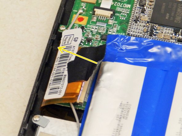

  4. Coby Kyros MID7024  Front Frame Replacement, Battery: crwdns2935265:04crwdnd2935265:01crwdnd2935265:03crwdne2935265:0 Coby Kyros MID7024  Front Frame Replacement, Battery: crwdns2935265:04crwdnd2935265:02crwdnd2935265:03crwdne2935265:0 Coby Kyros MID7024  Front Frame Replacement, Battery: crwdns2935265:04crwdnd2935265:03crwdnd2935265:03crwdne2935265:0

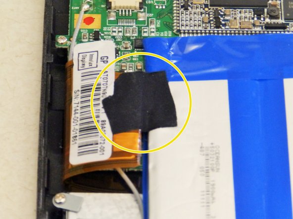

    • Locate the black tape connected to the battery and peel it back as indicated in the images.

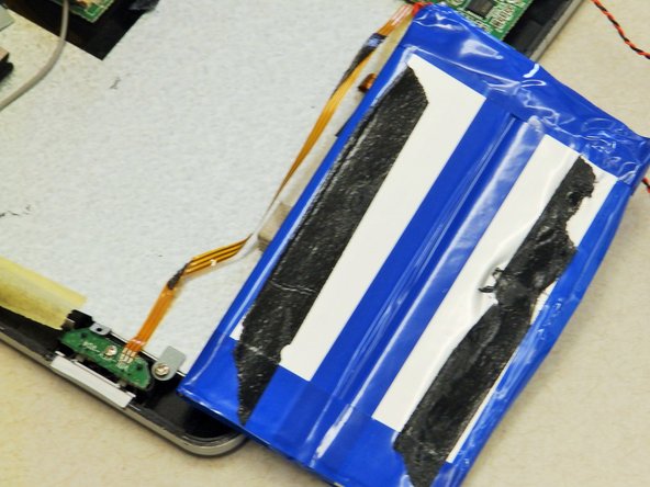

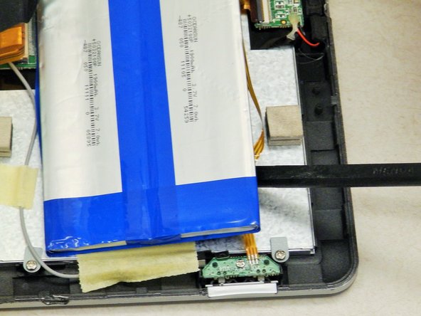

    • The battery is held to the device with two adhesive strips located on its underside.
    • After the battery is freed from the device, it will remain connected to the motherboard by two short wires.
    • Use the spudger tool to gently pry around both sides of the battery until it can be lifted from the device.
    • Roll the battery over (as shown in the image) so that its underside is now facing up. This will prevent damage to the motherboard.

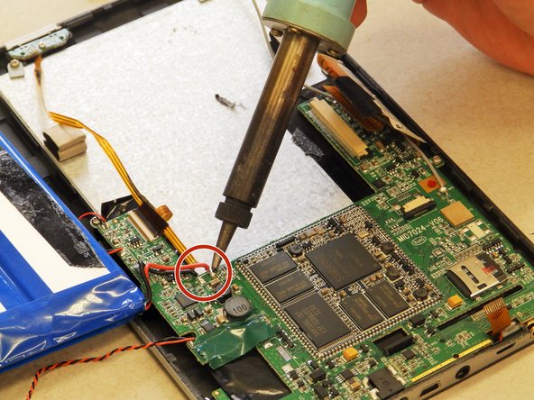

  6. Coby Kyros MID7024  Front Frame Replacement: crwdns2935265:06crwdnd2935265:01crwdnd2935265:02crwdne2935265:0 Coby Kyros MID7024  Front Frame Replacement: crwdns2935265:06crwdnd2935265:02crwdnd2935265:02crwdne2935265:0
    • Use a soldering gun to remove the positive and negative wires connecting the battery to the motherboard.
    • Follow the guide on soldering to assist you in removing the battery.

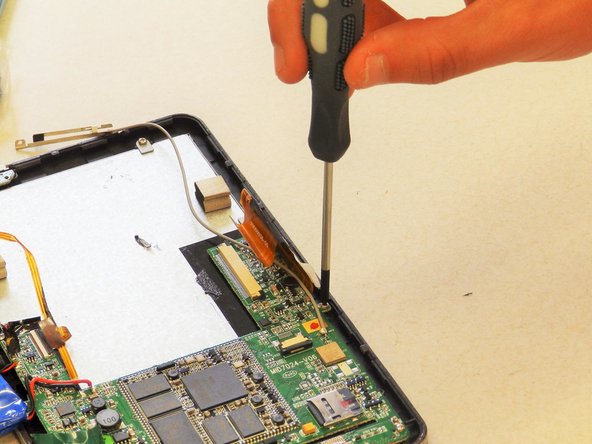

  7. Coby Kyros MID7024  Front Frame Replacement, Motherboard: crwdns2935265:07crwdnd2935265:01crwdnd2935265:02crwdne2935265:0 Coby Kyros MID7024  Front Frame Replacement, Motherboard: crwdns2935265:07crwdnd2935265:02crwdnd2935265:02crwdne2935265:0
    • Locate the four 5mm screws holding the motherboard in place and remove them using the Phillips #0 Screwdriver.
    • Upon removal of the screws the motherboard should be able to lift up some. Do not remove it until all of the ribbon cables have been detached.

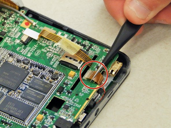

  8. Coby Kyros MID7024  Front Frame Replacement: crwdns2935265:08crwdnd2935265:01crwdnd2935265:03crwdne2935265:0 Coby Kyros MID7024  Front Frame Replacement: crwdns2935265:08crwdnd2935265:02crwdnd2935265:03crwdne2935265:0 Coby Kyros MID7024  Front Frame Replacement: crwdns2935265:08crwdnd2935265:03crwdnd2935265:03crwdne2935265:0

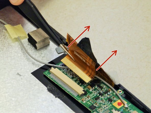

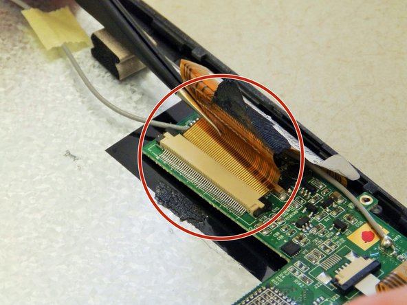

    • Locate the four ribbon cables shown in the yellow highlighted areas.
    • The digitizer is connected by a ZIF (zero insertion force) connector. The two black pieces on each end need to be pressed in simultaneously before the ribbon cable can be removed.
    • While pressing the black pieces, grasp the digitizer ribbon cable (widest one) with the tweezers and pull away from the connector as shown.

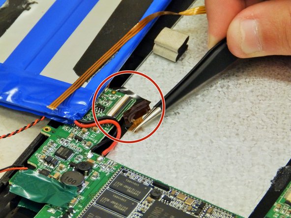

  9. Coby Kyros MID7024  Front Frame Replacement: crwdns2935265:09crwdnd2935265:01crwdnd2935265:03crwdne2935265:0 Coby Kyros MID7024  Front Frame Replacement: crwdns2935265:09crwdnd2935265:02crwdnd2935265:03crwdne2935265:0 Coby Kyros MID7024  Front Frame Replacement: crwdns2935265:09crwdnd2935265:03crwdnd2935265:03crwdne2935265:0
    • Carefully remove the remaining ribbon cables using the tweezers. Make sure that all ribbon cables are detatched before attempting to remove the motherboard.

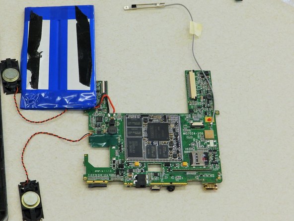

    • Now gently remove the motherboard from the device.

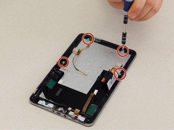

  11. Coby Kyros MID7024  Front Frame Replacement, LCD Digitizer: crwdns2935265:011crwdnd2935265:01crwdnd2935265:02crwdne2935265:0 Coby Kyros MID7024  Front Frame Replacement, LCD Digitizer: crwdns2935265:011crwdnd2935265:02crwdnd2935265:02crwdne2935265:0
    • Be sure that the back cover, battery, and motherboard are all removed from the device as shown.
    • Be sure that all ribbon cables are disconnected and held out of the way.
    • Lay the device face down on the table so the metallic back of the digitizer is facing upwards.
    • Use a Phillips screwdriver to unscrew the four 5mm screws holding the digitizer to the frame.

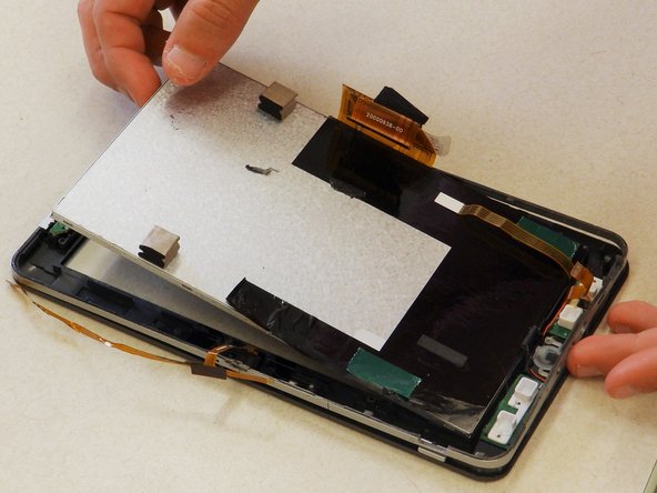

  12. Coby Kyros MID7024  Front Frame Replacement: crwdns2935265:012crwdnd2935265:01crwdnd2935265:03crwdne2935265:0 Coby Kyros MID7024  Front Frame Replacement: crwdns2935265:012crwdnd2935265:02crwdnd2935265:03crwdne2935265:0 Coby Kyros MID7024  Front Frame Replacement: crwdns2935265:012crwdnd2935265:03crwdnd2935265:03crwdne2935265:0

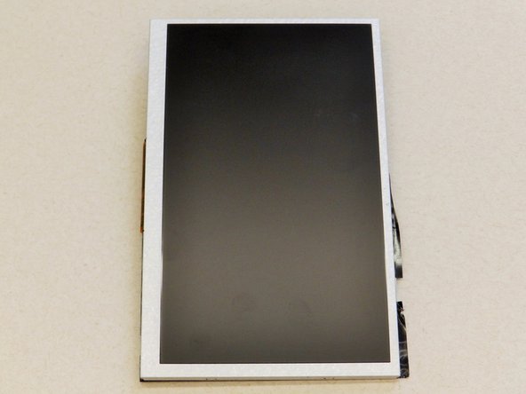

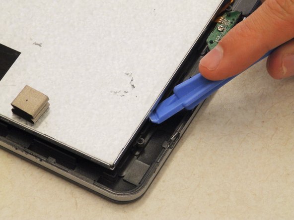

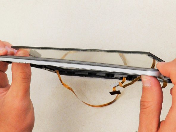

    • Use a plastic opening tool to wedge underneath the digitizer and pry up, lifting the digitizer out of the frame.
  13. Coby Kyros MID7024  Front Frame Replacement: crwdns2935265:013crwdnd2935265:01crwdnd2935265:02crwdne2935265:0 Coby Kyros MID7024  Front Frame Replacement: crwdns2935265:013crwdnd2935265:02crwdnd2935265:02crwdne2935265:0

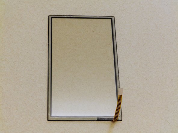

    • The digitizer is now free from the front frame and ready to be repaired or replaced.

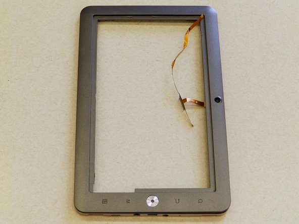

  15. Coby Kyros MID7024  Front Frame Replacement, Front Frame: crwdns2935265:015crwdnd2935265:01crwdnd2935265:02crwdne2935265:0 Coby Kyros MID7024  Front Frame Replacement, Front Frame: crwdns2935265:015crwdnd2935265:02crwdnd2935265:02crwdne2935265:0
    • The front bezel is now free from the device and is ready to be repaired or replaced.
