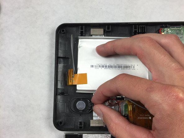

    • Wedge the metal spudger in between the faceplate and the body of the tablet.
    • Carefully pry the faceplate away from the body of the tablet.
  2. Coby Kyros MID7012 Speaker Replacement: crwdns2935265:02crwdnd2935265:01crwdnd2935265:01crwdne2935265:0
    • Carefully lift the screen and set it face down on a soft surface to not scratch it.

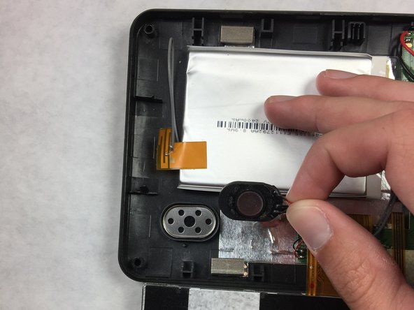

  3. Coby Kyros MID7012 Speaker Replacement: crwdns2935265:03crwdnd2935265:01crwdnd2935265:03crwdne2935265:0 Coby Kyros MID7012 Speaker Replacement: crwdns2935265:03crwdnd2935265:02crwdnd2935265:03crwdne2935265:0 Coby Kyros MID7012 Speaker Replacement: crwdns2935265:03crwdnd2935265:03crwdnd2935265:03crwdne2935265:0
    • Lift the speaker out of the speaker housing.

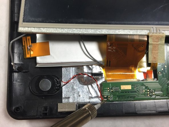

  4. Coby Kyros MID7012 Speaker Replacement: crwdns2935265:04crwdnd2935265:01crwdnd2935265:02crwdne2935265:0 Coby Kyros MID7012 Speaker Replacement: crwdns2935265:04crwdnd2935265:02crwdnd2935265:02crwdne2935265:0
    • Remove the positive and negative speaker wires by heating up the solder on the motherboard.
    • Here are some tips on how to Solder.
