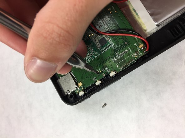

    • Remove the four 3.8 mm screws securing together the frame using the Phillips #000 Screwdriver.
  4. Coby Kyros MID7012 Screen Replacement: crwdns2935265:04crwdnd2935265:01crwdnd2935265:01crwdne2935265:0
    • Remove the two ribbon cable connectors from the motherboard by pulling the black connection out of the white connection on the motherboard.
    • To disconnect the connector, use the spudger or clean fingernail to lift the tab away from the connector.
