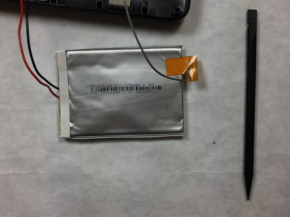

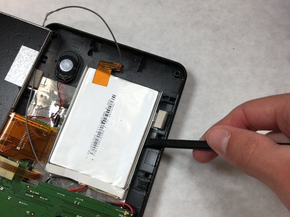

    • Carefully pry the battery away from the body of the tablet using the plastic spudger.
  5. Coby Kyros MID7012 Battery Replacement: crwdns2935265:05crwdnd2935265:01crwdnd2935265:02crwdne2935265:0 Coby Kyros MID7012 Battery Replacement: crwdns2935265:05crwdnd2935265:02crwdnd2935265:02crwdne2935265:0

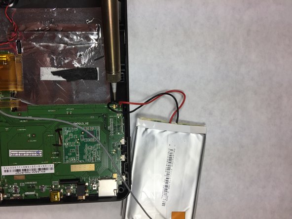

    • Using a soldering iron heat up the location where the wire meets the motherboard. Remove the red wire first, then the black wire.
    • Clip the grey wire about an inch from the ribbon using a sharp object.
