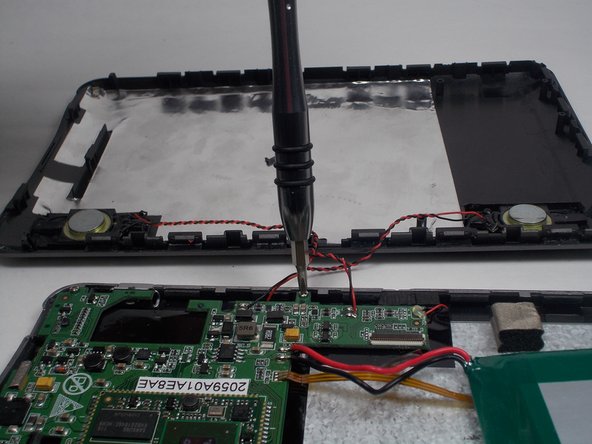

  4. Coby KYROS MID7125 Side Lock Button Replacement: crwdns2935265:04crwdnd2935265:01crwdnd2935265:02crwdne2935265:0 Coby KYROS MID7125 Side Lock Button Replacement: crwdns2935265:04crwdnd2935265:02crwdnd2935265:02crwdne2935265:0
    • Using the philips head screw driver size PH0, unscrew the screws holding the mother board to the device.
  5. Coby KYROS MID7125 Side Lock Button Replacement: crwdns2935265:05crwdnd2935265:01crwdnd2935265:01crwdne2935265:0
    • Using the plastic Spudger, pop the mother board out of place to expose the broken button piece.
    • Be sure to not pull the mother board out to much, some of the soldered wired connections may break.
  6. Coby KYROS MID7125 Side Lock Button Replacement: crwdns2935265:06crwdnd2935265:01crwdnd2935265:01crwdne2935265:0
    • Use the plastic Spudger to remove broken power button, and then pop in new power button after removal.
    • Reverse steps 1-5 to reassemble.
