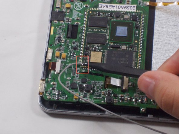

    • There are 5 ribbon cables connected to the motherboard. Two of these cables are clipped on and one is soldered on. Remove the 4 ribbon cables you can clip off using the plastic spudger.
    • For large ribbon cable use plastic spudger or your fingers to release ribbon cable clip by pulling the black edges down and pulling ribbon cable out.
    • For ribbon cable on the left side, flip up black hinge to remove ribbon cable
    • Desolder fifth ribbon cable with soldering station.
    • If soldering is new for you, then follow this useful guide on soldering and desoldering connections.

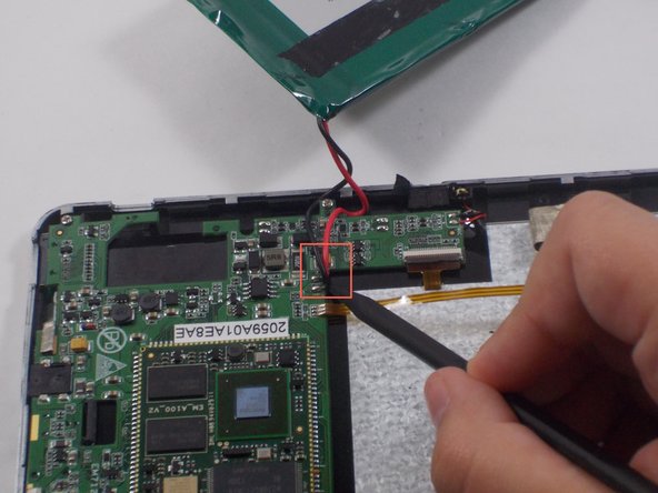

    • Desolder 2 speaker wires
    • Desolder Battery
    • Desolder antenna wire
    • Disconnect all wires you desoldered

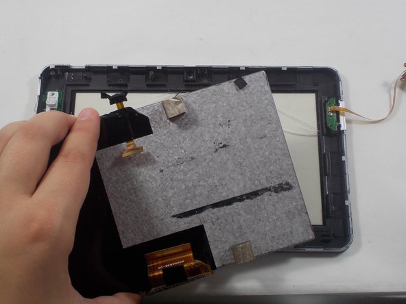

    • Remove 4 screws on corners of the digitizer and lift off.
  8. Coby KYROS MID7125 Screen Replacement: crwdns2935265:08crwdnd2935265:01crwdnd2935265:02crwdne2935265:0 Coby KYROS MID7125 Screen Replacement: crwdns2935265:08crwdnd2935265:02crwdnd2935265:02crwdne2935265:0
    • Now that the digitizer is disconnected from the screen you can replace the screen.

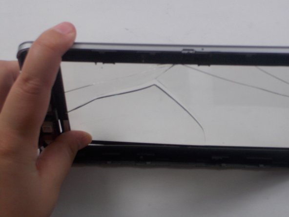

    • Place the screen face down in front of you facing downward and apply pressure with your thumbs around the outside of the glass to remove the screen.
    • Next, replace with your new screen and follow steps in reverse order to reassemble.
