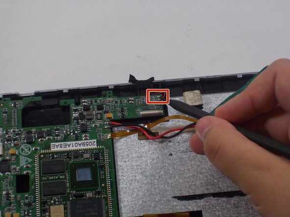

    • There are 5 ribbon cables connected to the motherboard. Two of these cables are clipped on and one is soldered on. Remove the 4 ribbon cables you can clip off using the plastic spudger
    • For large ribbon cable use plastic spudger or your fingers to release ribbon cable clip by pulling the black edges down and pulling ribbon cable out.
    • For ribbon cable on the left side, flip up black hinge to remove ribbon cable

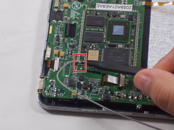

    • Desolder fifth ribbon cable with soldering station.

    • Desolder 2 speaker wires
    • Desolder antenna wire
    • Desolder microphone wire
    • Remove all wires you just desoldered.
  4. Coby KYROS MID7125 Motherboard Replacement: crwdns2935265:04crwdnd2935265:01crwdnd2935265:01crwdne2935265:0
    • Desolder the battery wires.

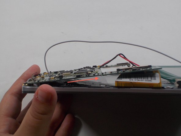

    • Unscrew 4 screws connecting around mother board using the J0 Phillips head screwdriver.
  6. Coby KYROS MID7125 Motherboard Replacement: crwdns2935265:06crwdnd2935265:01crwdnd2935265:02crwdne2935265:0 Coby KYROS MID7125 Motherboard Replacement: crwdns2935265:06crwdnd2935265:02crwdnd2935265:02crwdne2935265:0
    • Use plastic spudger to take off motherboard by lifting off right hand side and pulling sideways.
