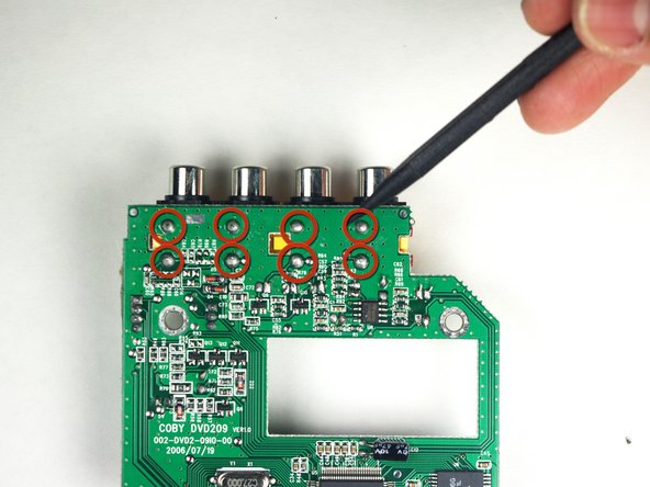

    • On the circuit board with the AVI Port, de-solder the circled areas on the back to remove the AVI Port.
