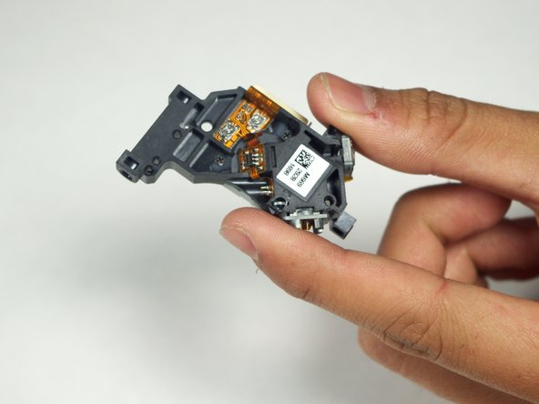

  6. Coby DVD209 DVD Laser Reader Replacement: crwdns2935265:06crwdnd2935265:01crwdnd2935265:02crwdne2935265:0 Coby DVD209 DVD Laser Reader Replacement: crwdns2935265:06crwdnd2935265:02crwdnd2935265:02crwdne2935265:0
    • Be careful not to lose the spring at the top of the laser.
    • Lift the laser assembly out of the fixture.

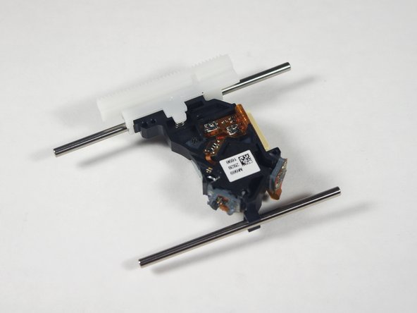

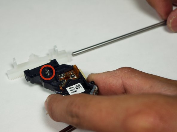

  7. Coby DVD209 DVD Laser Reader Replacement: crwdns2935265:07crwdnd2935265:01crwdnd2935265:03crwdne2935265:0 Coby DVD209 DVD Laser Reader Replacement: crwdns2935265:07crwdnd2935265:02crwdnd2935265:03crwdne2935265:0 Coby DVD209 DVD Laser Reader Replacement: crwdns2935265:07crwdnd2935265:03crwdnd2935265:03crwdne2935265:0
    • Remove the rails from the disk reader.
    • Once the top rail is removed, the white gear will come off and under it will be one of the springs.
