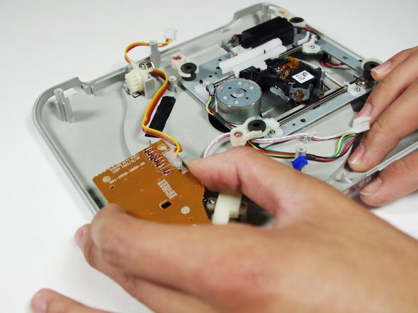

  4. Coby DVD209 Circuit Board for Buttons Replacement, Circuit Board for Buttons: crwdns2935265:04crwdnd2935265:01crwdnd2935265:02crwdne2935265:0 Coby DVD209 Circuit Board for Buttons Replacement, Circuit Board for Buttons: crwdns2935265:04crwdnd2935265:02crwdnd2935265:02crwdne2935265:0
    • Take the top portion of the DVD player and orient the device as shown in the first picture.
    • Remove the four 0.2" screws circled in red.

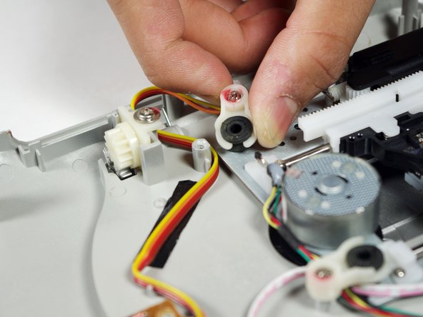

  5. Coby DVD209 Circuit Board for Buttons Replacement: crwdns2935265:05crwdnd2935265:01crwdnd2935265:03crwdne2935265:0 Coby DVD209 Circuit Board for Buttons Replacement: crwdns2935265:05crwdnd2935265:02crwdnd2935265:03crwdne2935265:0 Coby DVD209 Circuit Board for Buttons Replacement: crwdns2935265:05crwdnd2935265:03crwdnd2935265:03crwdne2935265:0
    • Losen the screw circled in red.
    • The screw will not come out of the plastic knob.
    • Turn the plastic knob 90 degrees to the right so that the cable comes out freely.
