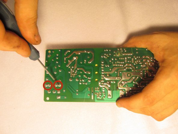

    7. Coby DVD-R11000 Fuse Replacement: crwdns2935265:010crwdnd2935265:01crwdnd2935265:02crwdne2935265:0 Coby DVD-R11000 Fuse Replacement: crwdns2935265:010crwdnd2935265:02crwdnd2935265:02crwdne2935265:0
      • Remove the two 1cm screws that are circled in red.
      • Place the blue plastic tool opener underneath the side of the circuit board and carefully remove it from the DVD player.
    1. Coby DVD-R11000 Fuse Replacement, Fuse: crwdns2935265:011crwdnd2935265:01crwdnd2935265:02crwdne2935265:0 Coby DVD-R11000 Fuse Replacement, Fuse: crwdns2935265:011crwdnd2935265:02crwdnd2935265:02crwdne2935265:0
      • De-solder the electronic components that are circled in red from the golden circuit board, which is the first one you removed.
