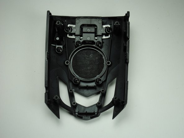

    • Remove the four 9.5 mm Phillips #0 screws from the back of the device.
  2. Cobra SPX 5300 Display Screen Replacement: crwdns2935265:02crwdnd2935265:01crwdnd2935265:02crwdne2935265:0 Cobra SPX 5300 Display Screen Replacement: crwdns2935265:02crwdnd2935265:02crwdnd2935265:02crwdne2935265:0
    • Pull the black plastic back case off of the device.
  3. Cobra SPX 5300 Display Screen Replacement: crwdns2935265:03crwdnd2935265:01crwdnd2935265:01crwdne2935265:0
    • Lift up the motherboard and lay it flat next to the device.
    • Be careful not to sever the wires. The buttonboard is connected to the motherboard by the wires.
  4. Cobra SPX 5300 Display Screen Replacement: crwdns2935265:04crwdnd2935265:01crwdnd2935265:01crwdne2935265:0
    • Remove the windshield bracket mount.
  5. Cobra SPX 5300 Display Screen Replacement, Buttonboard: crwdns2935265:05crwdnd2935265:01crwdnd2935265:01crwdne2935265:0
    • Remove the four 4.8 mm Phillips #00 screws from the buttonboard.
  6. Cobra SPX 5300 Display Screen Replacement: crwdns2935265:06crwdnd2935265:01crwdnd2935265:01crwdne2935265:0
    • Lift buttonboard to expose silver button plate.
  7. Cobra SPX 5300 Display Screen Replacement, Buttons: crwdns2935265:07crwdnd2935265:01crwdnd2935265:01crwdne2935265:0
    • Remove the silver button plate by gripping one of the corners and pulling up.
  8. Cobra SPX 5300 Display Screen Replacement, Display Screen: crwdns2935265:08crwdnd2935265:01crwdnd2935265:02crwdne2935265:0 Cobra SPX 5300 Display Screen Replacement, Display Screen: crwdns2935265:08crwdnd2935265:02crwdnd2935265:02crwdne2935265:0
    • Lift the front black plastic display screen.
