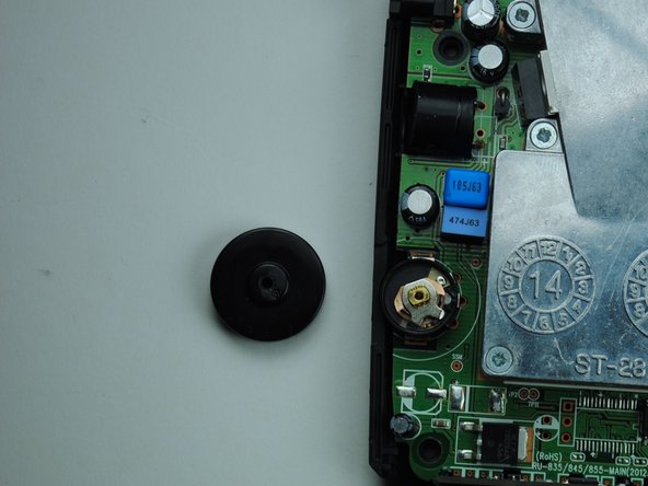

    • Remove the four 9.5 mm Phillips #0 screws from the back of the device.
  2. Cobra SPX 5300 Audio Dial Replacement: crwdns2935265:02crwdnd2935265:01crwdnd2935265:02crwdne2935265:0 Cobra SPX 5300 Audio Dial Replacement: crwdns2935265:02crwdnd2935265:02crwdnd2935265:02crwdne2935265:0
    • Pull the black plastic back case off of the device.
  3. Cobra SPX 5300 Audio Dial Replacement: crwdns2935265:03crwdnd2935265:01crwdnd2935265:01crwdne2935265:0
    • Lift up the motherboard and lay it flat next to the device.
    • Be careful not to sever the wires. The buttonboard is connected to the motherboard by the wires.
  4. Cobra SPX 5300 Audio Dial Replacement: crwdns2935265:04crwdnd2935265:01crwdnd2935265:01crwdne2935265:0
    • Remove the windshield bracket mount.
  5. Cobra SPX 5300 Audio Dial Replacement, Audio Dial: crwdns2935265:05crwdnd2935265:01crwdnd2935265:01crwdne2935265:0
    • Remove the one 4.8 mm Phillips #00 screw from the center of the audio dial.
  6. Cobra SPX 5300 Audio Dial Replacement: crwdns2935265:06crwdnd2935265:01crwdnd2935265:02crwdne2935265:0 Cobra SPX 5300 Audio Dial Replacement: crwdns2935265:06crwdnd2935265:02crwdnd2935265:02crwdne2935265:0
    • Remove audio dial.
