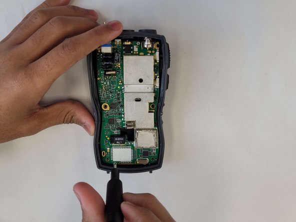

  6. Cobra MR HH350 FLT Screen Replacement: crwdns2935265:06crwdnd2935265:01crwdnd2935265:02crwdne2935265:0 Cobra MR HH350 FLT Screen Replacement: crwdns2935265:06crwdnd2935265:02crwdnd2935265:02crwdne2935265:0
    • Remove the 2 6mm screws on the motherboard with a #0 Phillips screwdriver.
  7. Cobra MR HH350 FLT Screen Replacement: crwdns2935265:07crwdnd2935265:01crwdnd2935265:01crwdne2935265:0
    • Remove the motherboard.

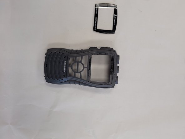

  8. Cobra MR HH350 FLT Screen Replacement, Screen: crwdns2935265:08crwdnd2935265:01crwdnd2935265:02crwdne2935265:0 Cobra MR HH350 FLT Screen Replacement, Screen: crwdns2935265:08crwdnd2935265:02crwdnd2935265:02crwdne2935265:0
    • Now that the motherboard is gone, the back of the screen is now accessible.
    • To remove the screen, you need to use the Jimmy in the IFIXIT tool kit. It may take some time due to the epoxy used to keep water from entering the device.
