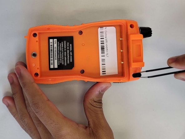

    • Remove the 11mm screw at the bottom of the radio with a #4 flathead screwdriver.
  2. Cobra MR HH350 FLT Button Replacement: crwdns2935265:02crwdnd2935265:01crwdnd2935265:01crwdne2935265:0
    • Remove the battery from the radio.
  3. Cobra MR HH350 FLT Button Replacement, Motherboard: crwdns2935265:03crwdnd2935265:01crwdnd2935265:02crwdne2935265:0 Cobra MR HH350 FLT Button Replacement, Motherboard: crwdns2935265:03crwdnd2935265:02crwdnd2935265:02crwdne2935265:0
    • Remove the 6 rubber stoppers using tweezers to reveal screws.
  4. Cobra MR HH350 FLT Button Replacement: crwdns2935265:04crwdnd2935265:01crwdnd2935265:01crwdne2935265:0
    • Remove the 6 10mm screws that were behind the rubber stoppers with a #0 Phillips screwdriver.
  5. Cobra MR HH350 FLT Button Replacement: crwdns2935265:05crwdnd2935265:01crwdnd2935265:01crwdne2935265:0

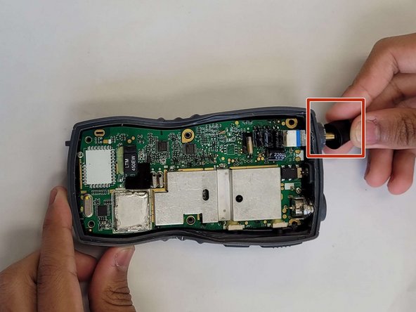

    • Remove the cover to expose the motherboard.
    • Pull off the power nob at the top of the radio.

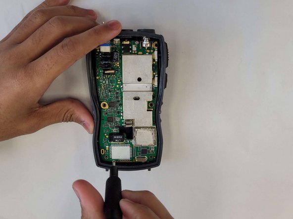

  6. Cobra MR HH350 FLT Button Replacement: crwdns2935265:06crwdnd2935265:01crwdnd2935265:02crwdne2935265:0 Cobra MR HH350 FLT Button Replacement: crwdns2935265:06crwdnd2935265:02crwdnd2935265:02crwdne2935265:0
    • Remove the 2 6mm screws on the motherboard with a #0 Phillips screwdriver.
  7. Cobra MR HH350 FLT Button Replacement: crwdns2935265:07crwdnd2935265:01crwdnd2935265:01crwdne2935265:0
    • Remove the motherboard.
