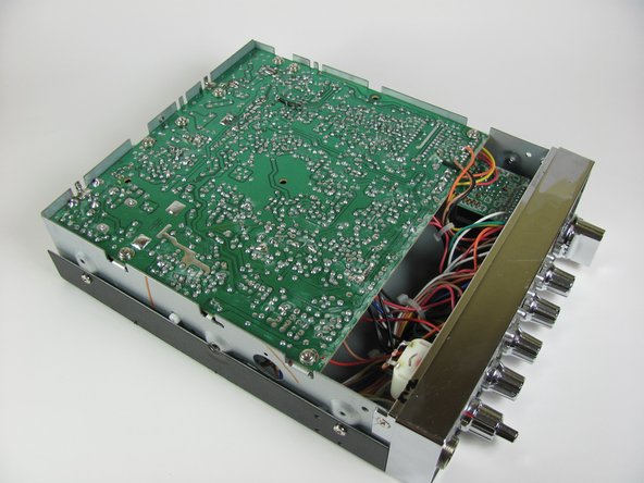

    • Gently set down on a hard, flat, non-conductive surface to minimize risk of shock or breaking your radio.
    • Carefully flip the radio over.

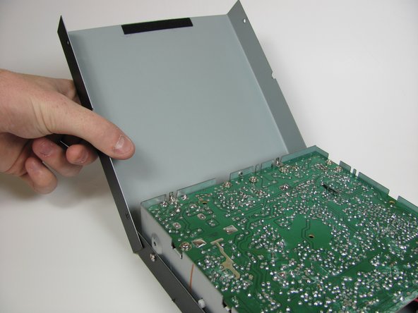

  10. Cobra 29 LTD Classic Internal Speaker Replacement: crwdns2935265:010crwdnd2935265:01crwdnd2935265:02crwdne2935265:0 Cobra 29 LTD Classic Internal Speaker Replacement: crwdns2935265:010crwdnd2935265:02crwdnd2935265:02crwdne2935265:0
    • Unscrew the four 6.0mm Phillips head screws counterclockwise on the left and right side of the device that connect the remaining cover, using a #1 Phillips head screwdriver.
  11. Cobra 29 LTD Classic Internal Speaker Replacement: crwdns2935265:011crwdnd2935265:01crwdnd2935265:03crwdne2935265:0 Cobra 29 LTD Classic Internal Speaker Replacement: crwdns2935265:011crwdnd2935265:02crwdnd2935265:03crwdne2935265:0 Cobra 29 LTD Classic Internal Speaker Replacement: crwdns2935265:011crwdnd2935265:03crwdnd2935265:03crwdne2935265:0

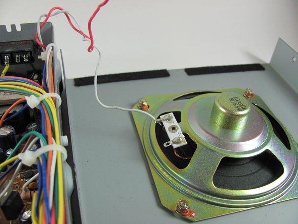

    • Watch out for the wires connected to the speaker. These short wires will not allow you to move the cover very far.
    • Gently lift and remove the case cover.

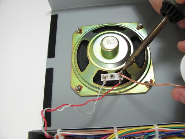

  12. Cobra 29 LTD Classic Internal Speaker Replacement, Internal Speaker: crwdns2935265:012crwdnd2935265:01crwdnd2935265:03crwdne2935265:0 Cobra 29 LTD Classic Internal Speaker Replacement, Internal Speaker: crwdns2935265:012crwdnd2935265:02crwdnd2935265:03crwdne2935265:0 Cobra 29 LTD Classic Internal Speaker Replacement, Internal Speaker: crwdns2935265:012crwdnd2935265:03crwdnd2935265:03crwdne2935265:0

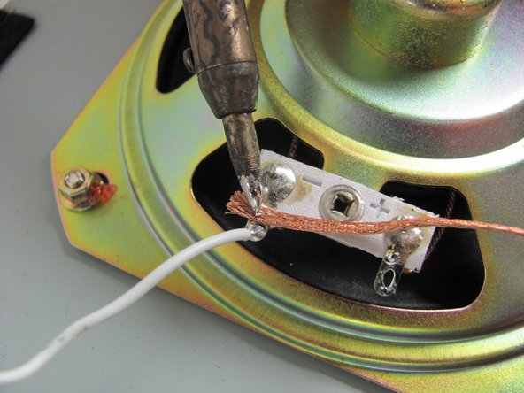

    • De-solder the red wire that is connected to the internal speaker, with a soldering iron and the desoldering wick.
    • During reassembly you will need to resolder the components back together.
  13. Cobra 29 LTD Classic Internal Speaker Replacement: crwdns2935265:013crwdnd2935265:01crwdnd2935265:02crwdne2935265:0 Cobra 29 LTD Classic Internal Speaker Replacement: crwdns2935265:013crwdnd2935265:02crwdnd2935265:02crwdne2935265:0
    • The wire may still be hot, so let it sit for 30 seconds before continuing.
    • Remove the red wire and make sure it is out of the way.
  14. Cobra 29 LTD Classic Internal Speaker Replacement: crwdns2935265:014crwdnd2935265:01crwdnd2935265:02crwdne2935265:0 Cobra 29 LTD Classic Internal Speaker Replacement: crwdns2935265:014crwdnd2935265:02crwdnd2935265:02crwdne2935265:0

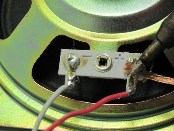

    • De-solder the white wire that is connected to the internal speaker, with a soldering iron and the desoldering wick.
  15. Cobra 29 LTD Classic Internal Speaker Replacement: crwdns2935265:015crwdnd2935265:01crwdnd2935265:01crwdne2935265:0
    • Pull the white wire out and set it aside.
    • The cover with the internal speaker should be completely separate from the device at this point.

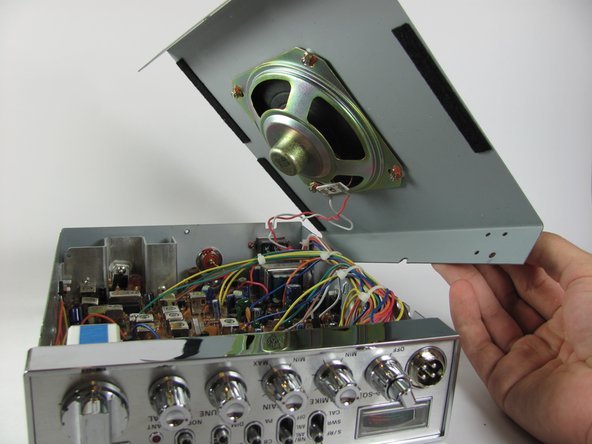

  16. Cobra 29 LTD Classic Internal Speaker Replacement: crwdns2935265:016crwdnd2935265:01crwdnd2935265:03crwdne2935265:0 Cobra 29 LTD Classic Internal Speaker Replacement: crwdns2935265:016crwdnd2935265:02crwdnd2935265:03crwdne2935265:0 Cobra 29 LTD Classic Internal Speaker Replacement: crwdns2935265:016crwdnd2935265:03crwdnd2935265:03crwdne2935265:0

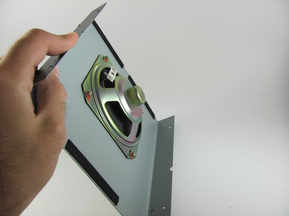

    • Gently flip the cover over.
    • The main body should be set aside on a non-static and flat surface. The cover with the internal speaker should now be by itself.
  17. Cobra 29 LTD Classic Internal Speaker Replacement: crwdns2935265:017crwdnd2935265:01crwdnd2935265:01crwdne2935265:0

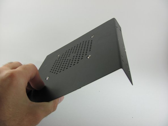

    • Unscrew the four 6.0 mm screws counterclockwise that surround the grate with a #1 Phillips Screwdriver.
    • When removing the four screws, the speaker may detach before you flip over the cover.
  18. Cobra 29 LTD Classic Internal Speaker Replacement: crwdns2935265:018crwdnd2935265:01crwdnd2935265:02crwdne2935265:0 Cobra 29 LTD Classic Internal Speaker Replacement: crwdns2935265:018crwdnd2935265:02crwdnd2935265:02crwdne2935265:0

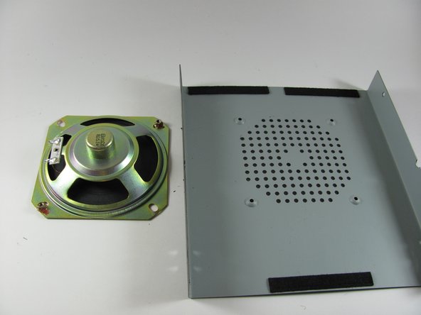

    • Flip the cover over and remove the speaker from the cover.
    • The nuts should remain attached to the speaker by lock-tight glue, however some might fall off.
