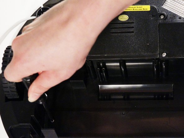

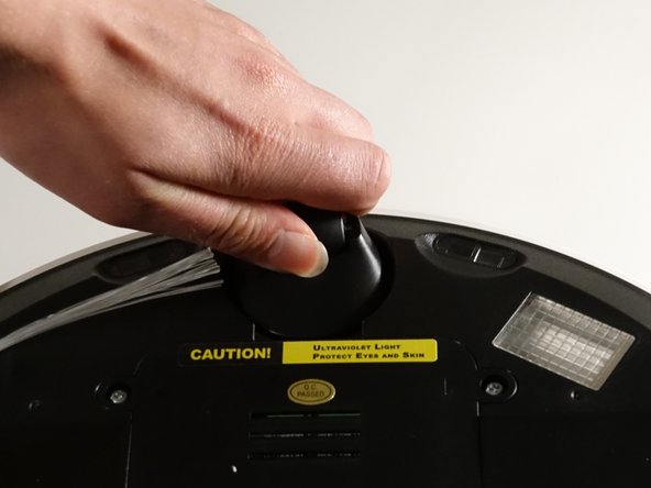

    • Remove bObi’s front wheel to access one of the screws holding bObi together.
    • Make sure the wheel is turned closer to bObi's front touch sensors. Use your screwdriver for leverage, and the wheel will pop up and out.
    • Uninstall the larger screw that sits deeper in the wheel compartment.

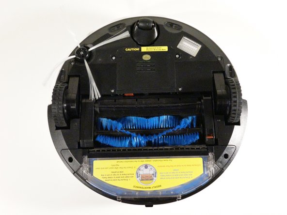

    • Remove bObi's dustbin.
    • Uninstall the 2 screws close to the bin and 2 smaller screws above her main brushes.

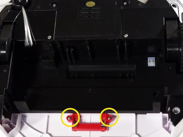

    • Remove the two screws on the dustbin contact point holder inside bObi.
    • There are 4 screws beneath the main brushes. Uninstall these, and open bObi up to expose her main circuit board.

    • Replace the dustbin contact point fastener on bObi and install its two screws.
