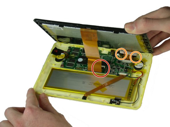

    4. ClickN Kids Tablet Touch Screen Display Replacement: crwdns2935265:04crwdnd2935265:01crwdnd2935265:02crwdne2935265:0 ClickN Kids Tablet Touch Screen Display Replacement: crwdns2935265:04crwdnd2935265:02crwdnd2935265:02crwdne2935265:0
      • Potential for device damage. Be careful not to damage any wires or ribbon cables during this step.
      • There are two ribbon cables to remove during this step. Each is connected to a base on the motherboard.
      • There is a black tab behind the long ribbon cable. Lift up the black tab.
      • For the ribbon cable in the back, pull the black tabs on the side out.
      • Detach the ribbon cables connecting the screen to the motherboard.
      • Remove any tape that is holding down the ribbon cables. Set it aside.
      • Once the ribbon cables are freed, separate the top and bottom sides.

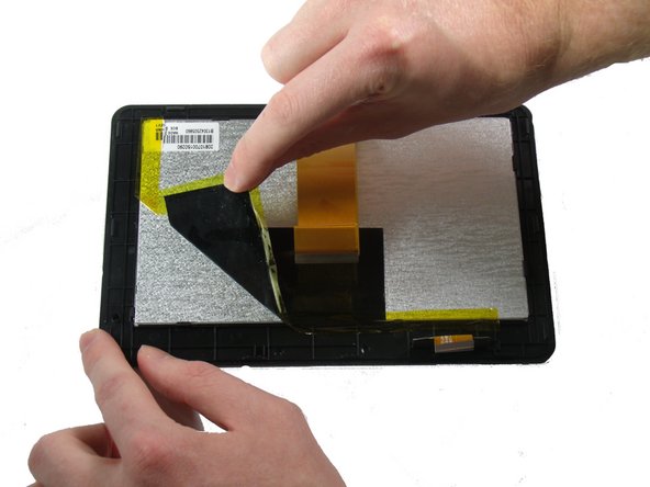

    5. ClickN Kids Tablet Touch Screen Display Replacement: crwdns2935265:05crwdnd2935265:01crwdnd2935265:02crwdne2935265:0 ClickN Kids Tablet Touch Screen Display Replacement: crwdns2935265:05crwdnd2935265:02crwdnd2935265:02crwdne2935265:0
      • Remove the yellow tape on the right side. Easiest side to get.
      • Remove the black and yellow tape stuck together on the left and bottom sides of the screen.

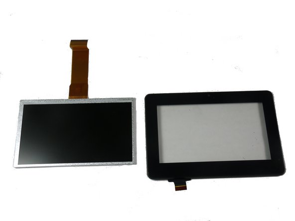

    6. ClickN Kids Tablet Touch Screen Display Replacement: crwdns2935265:06crwdnd2935265:01crwdnd2935265:01crwdne2935265:0
      • Potential for device damage. Make sure the screen is facedown and level to prevent or reduce damage to the display.
      • Potential for device damage. There is an adhesive on the top edge of the display’s face. Be careful not to damage the display.
      • Flex the sides of the tablet until the clips holding the display to the screen case pop loose.
    7. ClickN Kids Tablet Touch Screen Display Replacement: crwdns2935265:07crwdnd2935265:01crwdnd2935265:02crwdne2935265:0 ClickN Kids Tablet Touch Screen Display Replacement: crwdns2935265:07crwdnd2935265:02crwdnd2935265:02crwdne2935265:0
      • Be careful not to damage the display or screen case.
      • Pull the display from the top side to detach it from the screen case.
