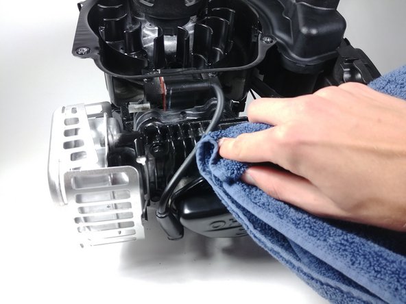

    • Ensure the engine is off and cooled down before starting this guide.
    • Using a 5/16" socket or wrench, remove the three bolts holding the plastic cover on to the engine.
    • Lift away the plastic cover. Note that the starter is attached to the cover and will come off with it.
  2. Cleaning/Degreasing Heat Sink: crwdns2935265:02crwdnd2935265:01crwdnd2935265:02crwdne2935265:0 Cleaning/Degreasing Heat Sink: crwdns2935265:02crwdnd2935265:02crwdnd2935265:02crwdne2935265:0
    • Using compressed air or a rag, clean debris from the flywheel.
  3. Cleaning/Degreasing Heat Sink, Cleaning/Degreasing Heat Sink: crwdns2935265:03crwdnd2935265:01crwdnd2935265:02crwdne2935265:0 Cleaning/Degreasing Heat Sink, Cleaning/Degreasing Heat Sink: crwdns2935265:03crwdnd2935265:02crwdnd2935265:02crwdne2935265:0
    • Using compressed air and a rag, clean the heat sink.
