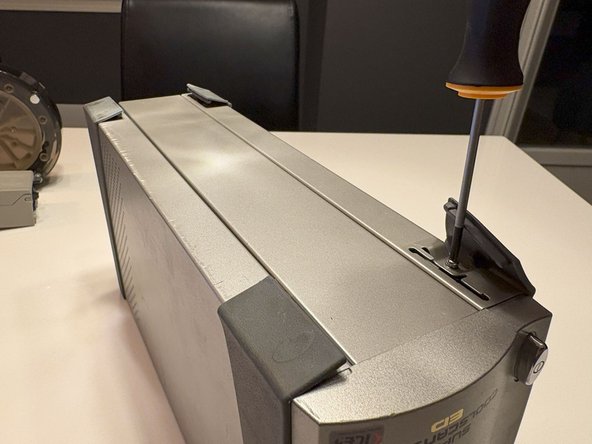

  2. Cleaning the mirror, Remove screws on the back: crwdns2935265:02crwdnd2935265:01crwdnd2935265:01crwdne2935265:0
    • Locate the Screws: Identify the six screws positioned on the back of the unit.
    • Prepare Your Tools: Gather the appropriate screwdriver, ensuring it matches the screw heads to avoid damage.
    • Unscrew Carefully: One by one, remove each of the six screws by turning them counterclockwise. Make sure to keep them in a safe place for reassembly.
    • Inspect the Unit: Once all screws are removed, gently check the back of the unit to ensure it is ready for further steps in the disassembly process.
  3. Cleaning the mirror, Remove hidden screws under Rubber pads: crwdns2935265:03crwdnd2935265:01crwdnd2935265:03crwdne2935265:0 Cleaning the mirror, Remove hidden screws under Rubber pads: crwdns2935265:03crwdnd2935265:02crwdnd2935265:03crwdne2935265:0 Cleaning the mirror, Remove hidden screws under Rubber pads: crwdns2935265:03crwdnd2935265:03crwdnd2935265:03crwdne2935265:0
    • Locate the Rubber Pads: As indicated by the red arrow above, find the four rubber pads positioned at the corners on the bottom of the scanner.
    • Remove the Pads: Gently pull out each rubber pad to expose the screws beneath them.
    • Prepare Your Tools: Ensure you have the appropriate screwdriver for the screws.
    • Unscrew: Carefully remove the four screws by turning them counterclockwise. Keep them safe for reassembly.
    • Remove the Shell: Once the screws are removed, gently slide the metal shell off the scanner, revealing the internal components.

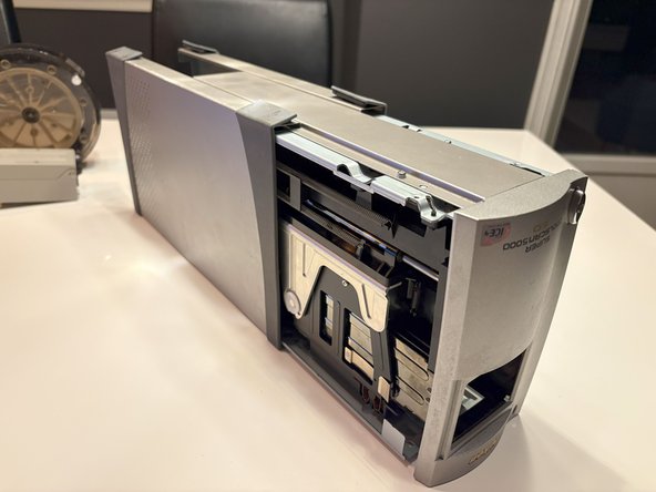

  4. Cleaning the mirror, Remove Bottom plate: crwdns2935265:04crwdnd2935265:01crwdnd2935265:01crwdne2935265:0
    • Identify the Screws: Locate the six screws marked by red circles in the diagram or image provided.
    • Prepare Your Tools: Ensure you have the correct screwdriver for the screws.
    • Unscrew: Carefully turn each screw counterclockwise until it is fully removed. Keep these screws in a safe place for reassembly.
    • Remove the Bottom Plate: Once all six screws are out, gently lift and remove the bottom metal plate from the unit, exposing the components beneath it.

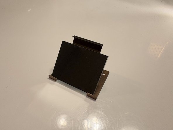

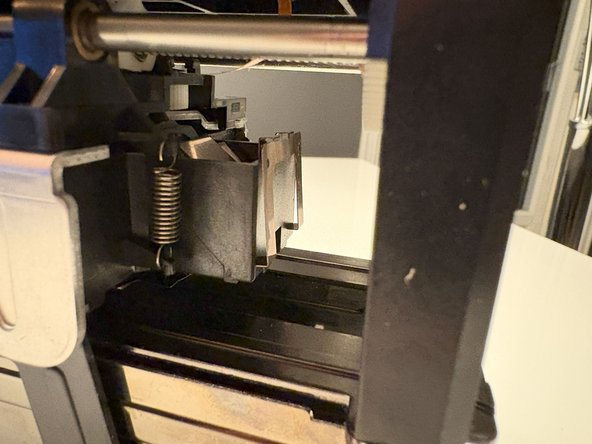

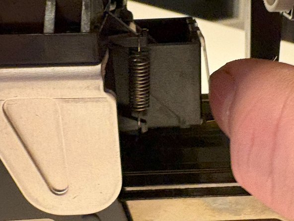

  6. Cleaning the mirror, Remove brass clip: crwdns2935265:06crwdnd2935265:01crwdnd2935265:03crwdne2935265:0 Cleaning the mirror, Remove brass clip: crwdns2935265:06crwdnd2935265:02crwdnd2935265:03crwdne2935265:0 Cleaning the mirror, Remove brass clip: crwdns2935265:06crwdnd2935265:03crwdnd2935265:03crwdne2935265:0
    • Remove brass clip: After moving the scan head back, you will have a clearer view of the mirror housing and the mirror itself, which is held in place by a brass clip.
    • Use a small flathead screwdriver or your nails to carefully lift the bottom fingers of the brass clip. Gently pull back one finger of the clip at a time, working from one side to the other
    • Exercise caution while removing the mirror, ensuring that the reflective surface does not come into contact with any objects. I recommend using both hands, reaching from either side of the scanner. To protect the mirror from oils on your hands, consider wearing rubber or latex gloves. It is safe to touch the back side or edges of the mirror
  7. Cleaning the mirror, Before and After cleaning: crwdns2935265:08crwdnd2935265:01crwdnd2935265:02crwdne2935265:0 Cleaning the mirror, Before and After cleaning: crwdns2935265:08crwdnd2935265:02crwdnd2935265:02crwdne2935265:0
    • Dust Removal: If it's just dust, use a small rubber bulb to blow it off.
    • Cleaning Solution: If the dust remains, use a glass cleaning solution and a microfiber cloth designed for glasses.
    • Note: It may take several attempts to get the mirror completely clean. Avoid touching the reflective surface with your hands or any hard objects to prevent damage.
