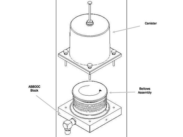

  6. Cleaning the Ulco Integrus PSV: crwdns2935265:06crwdnd2935265:01crwdnd2935265:02crwdne2935265:0 Cleaning the Ulco Integrus PSV: crwdns2935265:06crwdnd2935265:02crwdnd2935265:02crwdne2935265:0
    • Bellows Assembly
    • Loosen the four knurled screws (1) and remove the bellows canister.
  7. Cleaning the Ulco Integrus PSV: crwdns2935265:07crwdnd2935265:01crwdnd2935265:01crwdne2935265:0
    • Remove the bellows assembly by rotating counter-clockwise. The bellows canister may be washed or autoclaved.
  8. Cleaning the Ulco Integrus PSV: crwdns2935265:08crwdnd2935265:01crwdnd2935265:01crwdne2935265:0
    • The base disk (mushroom) should be removed from the bellows assembly before washing. Pull the latex-free rubber bag from the delrin base disk. The bellows may be washed or autoclaved. The base component (mushroom) should not be autoclaved but can be put through a washer at 80°C.
    • Dry all components thoroughly before re-assembly.
    • Low pressure warm air should be passed through the absorber head by attaching a hose to the scavenge port
