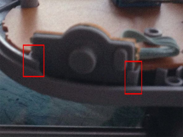

    • Remove the 9 external screws (4.8 mm Phillips head) on the back of the controller.
    • Remove the back panel from the controller.
  2. Cleaning the Controller Buttons: crwdns2935265:02crwdnd2935265:01crwdnd2935265:03crwdne2935265:0 Cleaning the Controller Buttons: crwdns2935265:02crwdnd2935265:02crwdnd2935265:03crwdne2935265:0 Cleaning the Controller Buttons: crwdns2935265:02crwdnd2935265:03crwdnd2935265:03crwdne2935265:0
    • Remove the 3 screws (4.8 mm Phillips head) from the back of the white box.
    • Remove the back panel of the joystick box.
    • There are many small plastic components loose in this box; be careful not to lose these.
    • Separate the rubber pads and plastic buttons from the controller.

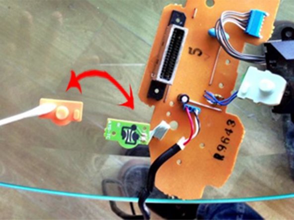

  3. Cleaning the Controller Buttons: crwdns2935265:03crwdnd2935265:01crwdnd2935265:02crwdne2935265:0 Cleaning the Controller Buttons: crwdns2935265:03crwdnd2935265:02crwdnd2935265:02crwdne2935265:0
    • Using a soft cleaning material, clean the plastic buttons.
    • Using a toothpick, clean the pole slot, shown at the right of the Q-Tip.
  4. Cleaning the Controller Buttons: crwdns2935265:04crwdnd2935265:01crwdnd2935265:02crwdne2935265:0 Cleaning the Controller Buttons: crwdns2935265:04crwdnd2935265:02crwdnd2935265:02crwdne2935265:0
    • Using a damp, soft cleaning material, clean the rubber button pads.
    • To ensure that no electrical damage occurs, ensure that you dry the pieces completely after cleaning them.
  5. Cleaning the Controller Buttons, Put it back together: crwdns2935265:05crwdnd2935265:01crwdnd2935265:01crwdne2935265:0
    • Reinsert the buttons, ensuring that the rubber, cylindrical pieces protruding from the buttons are lined up with their corresponding circuits.
Follow these steps in reverse order to reassemble your device.
