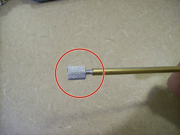

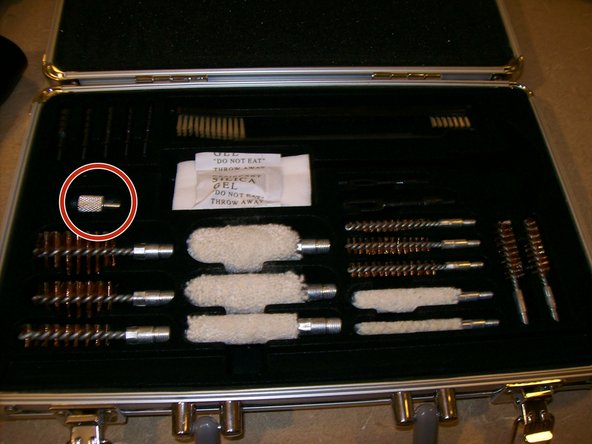

  3. Cleaning a  Browning BPS Shotgun, Assemble Ramrod: crwdns2935265:04crwdnd2935265:01crwdnd2935265:03crwdne2935265:0 Cleaning a  Browning BPS Shotgun, Assemble Ramrod: crwdns2935265:04crwdnd2935265:02crwdnd2935265:03crwdne2935265:0 Cleaning a  Browning BPS Shotgun, Assemble Ramrod: crwdns2935265:04crwdnd2935265:03crwdnd2935265:03crwdne2935265:0
    • Screw the three pieces of the ramrod together.
    • Ramrod: A long, straight metal rod that is paired with a cotton mop or wire brush to clean the inside of a barrel.
    • Connect the adapter to the end of the ramrod.

    • Connect the 12 gauge wire brush to the ramrod. Slide this all the way to the bottom of the barrel and then out two to three times. It may help to place the butt of the gun on the floor.
    • Wire Brush: A metal brush that attaches to the ramrod and is used to clean the inside of the barrel.
    • Detach the wire brush from the ramrod and attach the 12 gauge cotton mop.
    • Cotton Mop: A cotton wad that attaches to the ramrod used to wipe the inside of the barrel with cleaning oil.

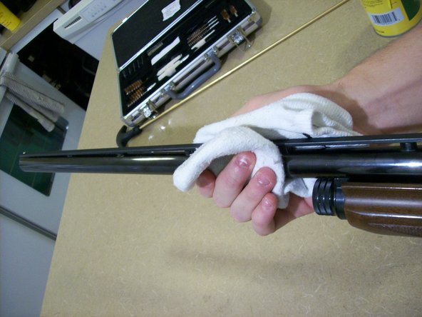

  6. Cleaning a  Browning BPS Shotgun, Cleaning the Interior of the Gun: crwdns2935265:07crwdnd2935265:01crwdnd2935265:03crwdne2935265:0 Cleaning a  Browning BPS Shotgun, Cleaning the Interior of the Gun: crwdns2935265:07crwdnd2935265:02crwdnd2935265:03crwdne2935265:0 Cleaning a  Browning BPS Shotgun, Cleaning the Interior of the Gun: crwdns2935265:07crwdnd2935265:03crwdnd2935265:03crwdne2935265:0
    • Spray a spot onto the rag with the Rem Oil and wipe down the outside of the action and wipe the inside of the magazine as far as you can. You made need to reapply Rem Oil to the rag if it runs out.
    • Action: Interior mechanism of the gun.
    • Slide the fore grip back and wipe down the chamber.
    • Use the rag to wipe down the magazine originally covered by the fore grip.
    • Press the slide release and slide the fore grip forwards or backwards to ensure the magazine is all clean.
