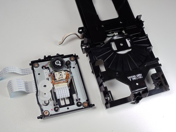

    • Gently lift the DVD tray off of the motherboard.
  11. Cleaning Samsung DVD-P230 Laser Lens, Cleaning Samsung DVD-P230 Laser Lens: crwdns2935265:011crwdnd2935265:01crwdnd2935265:02crwdne2935265:0 Cleaning Samsung DVD-P230 Laser Lens, Cleaning Samsung DVD-P230 Laser Lens: crwdns2935265:011crwdnd2935265:02crwdnd2935265:02crwdne2935265:0
    • Spin small gear shown right to begin opening the tray. There should be relatively little resistance in the gear.
  12. Cleaning Samsung DVD-P230 Laser Lens: crwdns2935265:012crwdnd2935265:01crwdnd2935265:03crwdne2935265:0 Cleaning Samsung DVD-P230 Laser Lens: crwdns2935265:012crwdnd2935265:02crwdnd2935265:03crwdne2935265:0 Cleaning Samsung DVD-P230 Laser Lens: crwdns2935265:012crwdnd2935265:03crwdnd2935265:03crwdne2935265:0

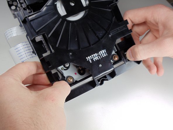

    • Use your fingers to pull the shown tabs towards the sides of the tray, releasing the internal tray that contains the laser.

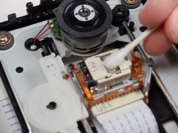

    • Use the cotton swab to wipe off lens

Thank you Mitchell for your clear, concise directions and photos. I was able to dismantle my Samsung DVD-VCR player Model DVD-V2000. It recently quit playing DVD’s, showing a “No Disc” message. It will play CD’s just fine. I cleaned the laser and reinstalled but still no DVD, just CD’s will play. I like the machine and may look into a replacement DVD assembly if I can find one for a reasonable price. Otherwise I’ll upgrade to a new combo unit with the latest bells and whistles. Best wishes, Bill
sherlockbill - crwdns2934203:0crwdne2934203:0
I successfully fixed the "No Disc" issue on a DVD/VCR model DVD-V5000. Your guide helped and it was basically the same process. I used a foam tip (well a makeup applicator to be more precise) instead of a cotton tip, because it is less likely to leave anything behind like cotton strands. All works now, thanks!
