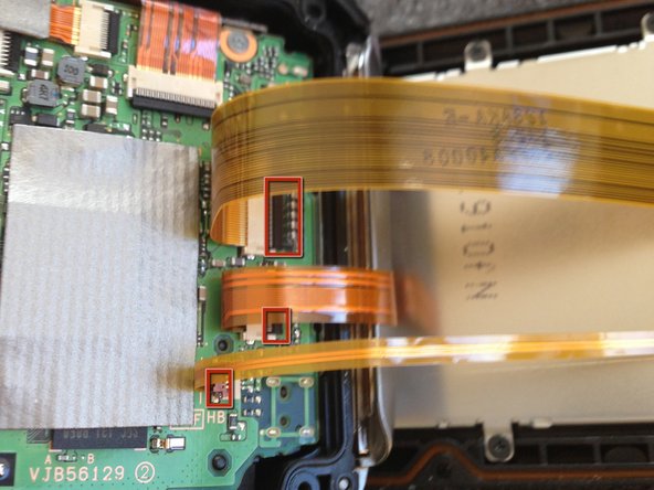

  4. Cleaning Panasonic Lumix DMC-TS3 CCD Sensor: crwdns2935265:04crwdnd2935265:01crwdnd2935265:02crwdne2935265:0 Cleaning Panasonic Lumix DMC-TS3 CCD Sensor: crwdns2935265:04crwdnd2935265:02crwdnd2935265:02crwdne2935265:0
    • Carefully remove the back lcd from the body, making sure not to damage the 3 connecting ribbons.
    • Using a spudger tool, unlatch the two larger ribbon connections by pressing up on the black connector.
    • The smaller one, has a brown connector, works in the opposite fashion.

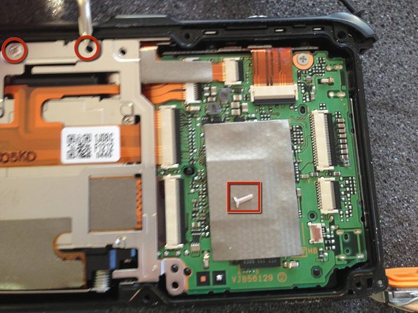

  5. Cleaning Panasonic Lumix DMC-TS3 CCD Sensor: crwdns2935265:05crwdnd2935265:01crwdnd2935265:03crwdne2935265:0 Cleaning Panasonic Lumix DMC-TS3 CCD Sensor: crwdns2935265:05crwdnd2935265:02crwdnd2935265:03crwdne2935265:0 Cleaning Panasonic Lumix DMC-TS3 CCD Sensor: crwdns2935265:05crwdnd2935265:03crwdnd2935265:03crwdne2935265:0
    • With the camera body face down, begin removing the screws securing the sensor assembly.
    • Remove the long screw in the lower center of the camera.
    • Remove the remaining 3 screws shown in the photos.
