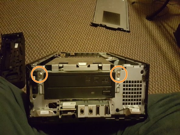

  6. Cleaning Inside Your Inspiron, Removing HDD & Optical Drive: crwdns2935265:06crwdnd2935265:01crwdnd2935265:02crwdne2935265:0 Cleaning Inside Your Inspiron, Removing HDD & Optical Drive: crwdns2935265:06crwdnd2935265:02crwdnd2935265:02crwdne2935265:0
    • Next remove the three screws holding the HDD and Optical Drive in place. It is very important that you DO NOT remove the drives yet as they are still plugged into the motherboard.

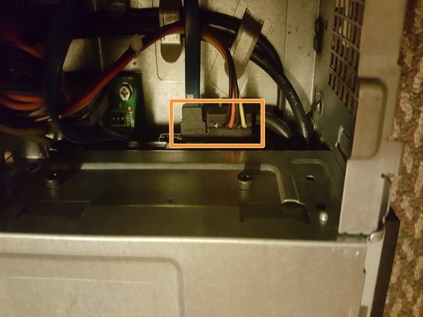

  7. Cleaning Inside Your Inspiron, Disconnecting the Cords: crwdns2935265:07crwdnd2935265:01crwdnd2935265:02crwdne2935265:0 Cleaning Inside Your Inspiron, Disconnecting the Cords: crwdns2935265:07crwdnd2935265:02crwdnd2935265:02crwdne2935265:0
    • Next we need to unplug the cables from the back of the Optical Drive and HDD. Do not grab the wires to pull. Get a firm grip on the hard plastic plugin and gently rock the cord side to side until it comes free.
    • Keep in mind there are two cords for your Optical Drive, and two cords for your HDD to make a total of four that need to be unplugged.

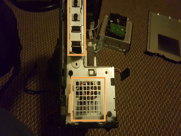

  8. Cleaning Inside Your Inspiron, Removing the Optical and HDD Drives: crwdns2935265:08crwdnd2935265:01crwdnd2935265:01crwdne2935265:0
    • Now that the screws are removed and cables unplugged. Very carefully lift the drives out. They slide directly up and out. Make sure to set your drives with the HDD facing up like you see in Red Box. To reassemble your drives carefully line them up in the space with the orange box outlined.
    • Then carefully set them inside the PC. It lines up perfect and comes close to the SATA cords on the motherboard. Make sure nothing is getting pressed down underneath when reassembling.

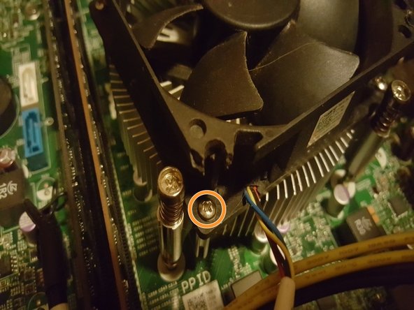

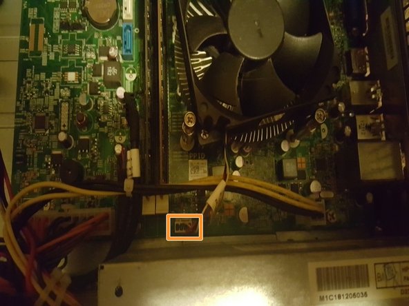

  10. Cleaning Inside Your Inspiron, Removing Heat Sink Fan: crwdns2935265:010crwdnd2935265:01crwdnd2935265:03crwdne2935265:0 Cleaning Inside Your Inspiron, Removing Heat Sink Fan: crwdns2935265:010crwdnd2935265:02crwdnd2935265:03crwdne2935265:0 Cleaning Inside Your Inspiron, Removing Heat Sink Fan: crwdns2935265:010crwdnd2935265:03crwdnd2935265:03crwdne2935265:0
    • Note: We are NOT removing the heat sink in this guide as that requires cleaning of its own and reapplying thermal paste. It is VERY important you check the second photo in this step to make sure you are taking the correct screws out.
    • Remove the four screws around the edge of the fan and make sure to unplug the power wire to the fan (Photo #3). Once unplugged and screws removed, you may gently take out the heat sink fan.

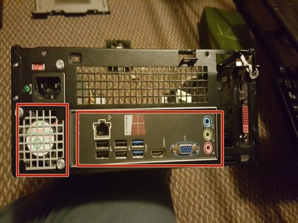

    • Make sure you spray underneath your motherboard. There is a small gap between your chassis and motherboard shown in the blue marker. Dust, pet hair, and other debris like to hide under there. To finish up make sure to spray the back peripheral ports and the front ports. Also spray down system fans making sure not to let them spin!
