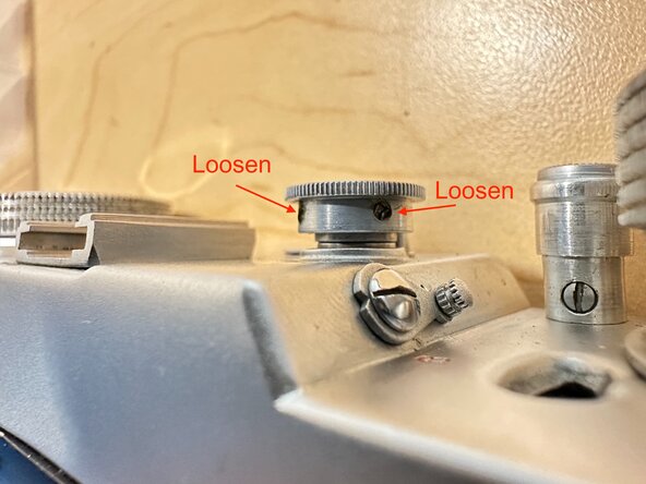

  1. Cleaning & lubricating a GOMZ Leningrad, Preparation for top cover removal: crwdns2935265:01crwdnd2935265:01crwdnd2935265:03crwdne2935265:0 Cleaning & lubricating a GOMZ Leningrad, Preparation for top cover removal: crwdns2935265:01crwdnd2935265:02crwdnd2935265:03crwdne2935265:0 Cleaning & lubricating a GOMZ Leningrad, Preparation for top cover removal: crwdns2935265:01crwdnd2935265:03crwdnd2935265:03crwdne2935265:0

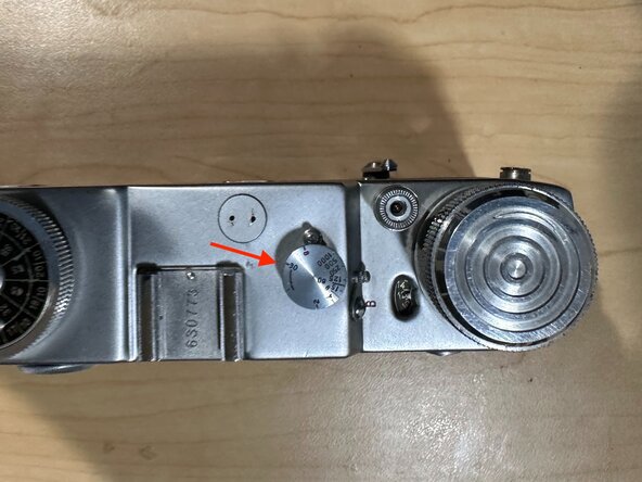

    • Remove the shutter speed dial.
    • Set the shutter speed to 1/30 as it conveniently exposes the set screws. However, one can still infer the correct position by turning the dial to one end (30) or by the dents for the screws.
    • Unscrew the two set screws. No need to extract them as they are easy to lose.
    • Pull up the dial.

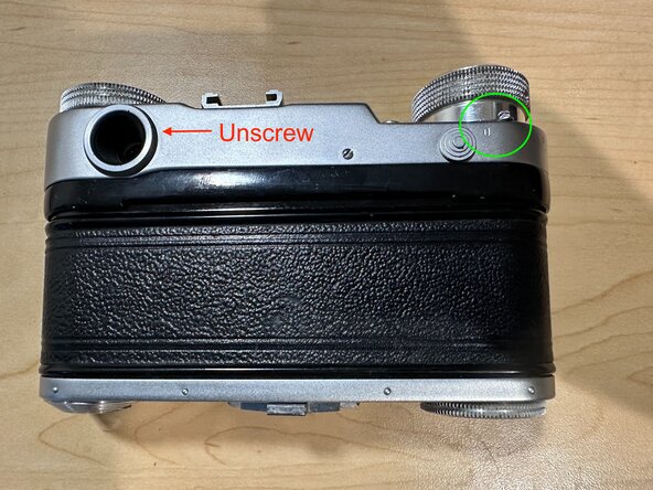

    • Set the flash sync dial to "0" for bookeeping. One may still infer the dial position by fitting the dial (on the camera body) between the lever notch (on the top cover).

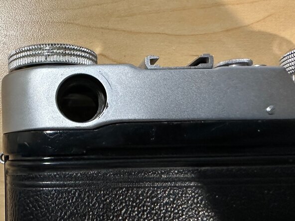

    • Unscrew the viewfinder eyepiece.
    • Pull up the rewind knob to the "rewind" configuration.
    • Release as much tension from the motor as possible by firing the shutter until the camera no longer autorewinds.

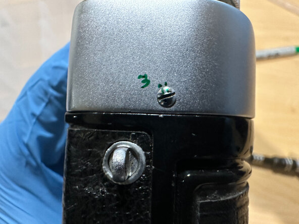

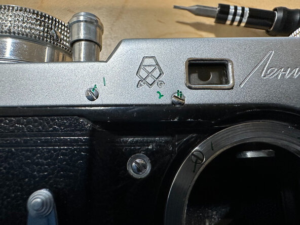

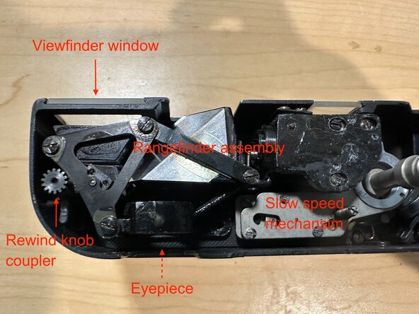

  2. Cleaning & lubricating a GOMZ Leningrad, Remove the top cover: crwdns2935265:02crwdnd2935265:01crwdnd2935265:03crwdne2935265:0 Cleaning & lubricating a GOMZ Leningrad, Remove the top cover: crwdns2935265:02crwdnd2935265:02crwdnd2935265:03crwdne2935265:0 Cleaning & lubricating a GOMZ Leningrad, Remove the top cover: crwdns2935265:02crwdnd2935265:03crwdnd2935265:03crwdne2935265:0
    • Remove the 4 set screws around the top cover.
    • There are 4 screw: front, back, left, and right
    • Screw #2 does not need to be removed. It covers the RF calibration access port.
    • Gently lift up the top cover.
    • Relieving as much tension in the motor spring as possible will make pulling up the cover much easier.

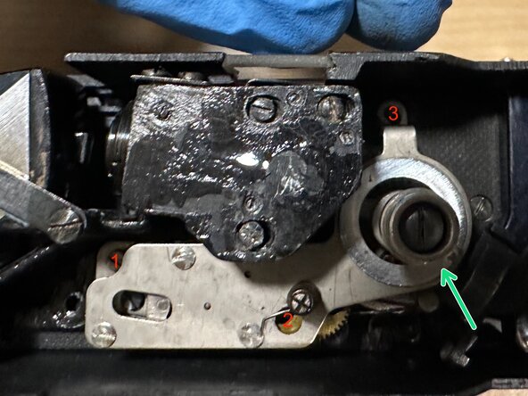

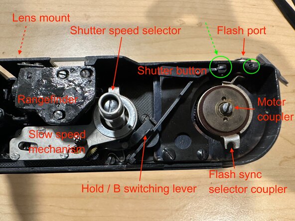

  3. Cleaning & lubricating a GOMZ Leningrad, Remove the shutter button and flash port: crwdns2935265:03crwdnd2935265:01crwdnd2935265:03crwdne2935265:0 Cleaning & lubricating a GOMZ Leningrad, Remove the shutter button and flash port: crwdns2935265:03crwdnd2935265:02crwdnd2935265:03crwdne2935265:0 Cleaning & lubricating a GOMZ Leningrad, Remove the shutter button and flash port: crwdns2935265:03crwdnd2935265:03crwdnd2935265:03crwdne2935265:0
    • With the top cover off, take a close look at the mechanism.
    • Unscrew and remove the shutter button and flash port.
    • The flash port screw is visible in the picture.
    • The shutter button screw is not pictured. It is on the front side of the camera as indicated by the green dashed arrow.

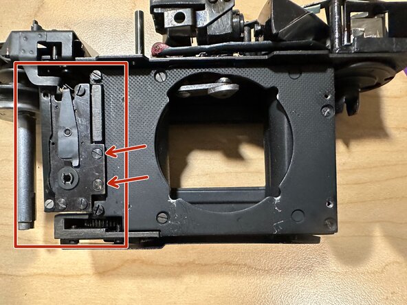

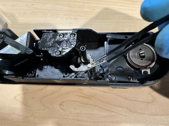

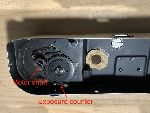

  4. Cleaning & lubricating a GOMZ Leningrad, Remove the slow speed mechansim: crwdns2935265:04crwdnd2935265:01crwdnd2935265:02crwdne2935265:0 Cleaning & lubricating a GOMZ Leningrad, Remove the slow speed mechansim: crwdns2935265:04crwdnd2935265:02crwdnd2935265:02crwdne2935265:0
    • Remove the 3 screws fastening the slow speed mechansim.
    • Screw #2 is hidden under a gear. To access it, rotate the gear so the hole aligns with the screw.
    • Remove the slow speed mechanism
    • Similar to all Soviet single-dial slow speed mechanisms (without separate escapement), it will release tension and buzz briefly upon removal.
    • During reassembly, the mechanism has to be pre-tensioned and installed quickly so the cam catches on before losing all tension.
    • Remove the speed selector by undoing the green screw.

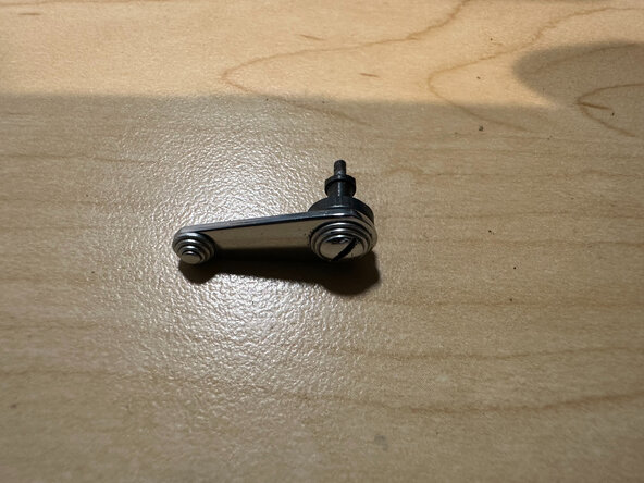

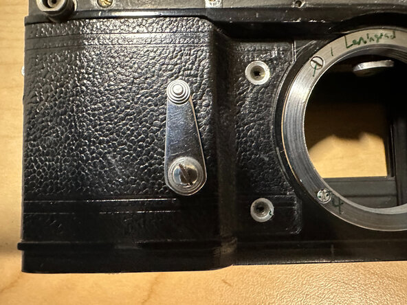

  5. Cleaning & lubricating a GOMZ Leningrad, Remove the self timer lever: crwdns2935265:05crwdnd2935265:01crwdnd2935265:02crwdne2935265:0 Cleaning & lubricating a GOMZ Leningrad, Remove the self timer lever: crwdns2935265:05crwdnd2935265:02crwdnd2935265:02crwdne2935265:0
    • Unscrew the flathead screw on the self timer lever.
    • Remove it.
    • Note that the camera was jammed when I took the picture. Normally the shutter curtain should be closed at this stage

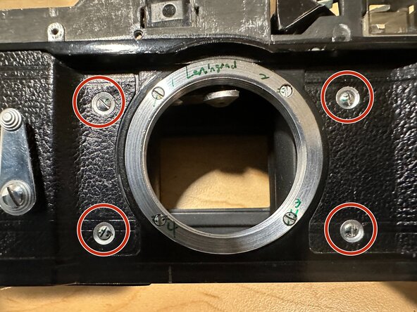

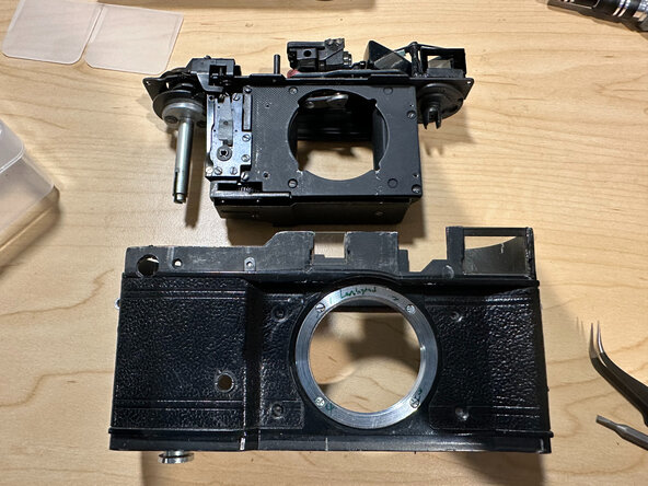

  6. Cleaning & lubricating a GOMZ Leningrad, Remove the chassis: crwdns2935265:06crwdnd2935265:01crwdnd2935265:03crwdne2935265:0 Cleaning & lubricating a GOMZ Leningrad, Remove the chassis: crwdns2935265:06crwdnd2935265:02crwdnd2935265:03crwdne2935265:0 Cleaning & lubricating a GOMZ Leningrad, Remove the chassis: crwdns2935265:06crwdnd2935265:03crwdnd2935265:03crwdne2935265:0
    • Remove the 4 front screws circled in red. Beware of the cone washers between the leatherette and the screws. They could fall out.
    • Early versions of Leningrad may only have 2 screws
    • Do not remove the screws on the mount (marked 1~4). There is no need. Reassembling the lens mount requires collimating.
    • Remove the 4 top screws.
    • Order the screws carefully. They may not be the same length.

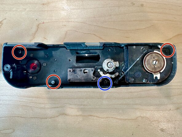

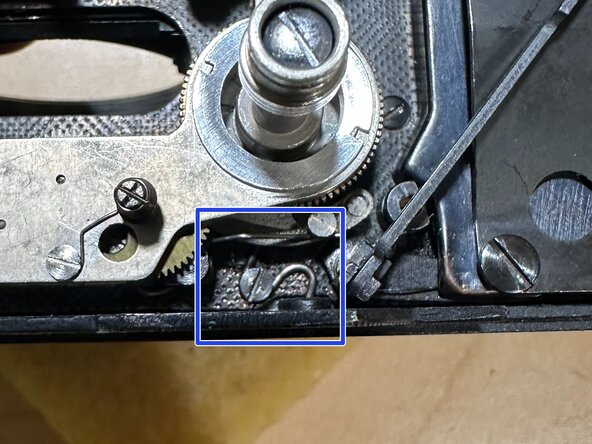

    • Pay special attention to how the S-shaped spring is arranged (blue circle and rectangle). It is crucial for absorbing the shock from the motor winder.
    • The pictured configuration shows the correct assembly. The left side of the spring stops the winding action. The right side holds the spring against the chassis. It is under a lot of tension and reassembling it is tricky.
    • Pull off the chassis.

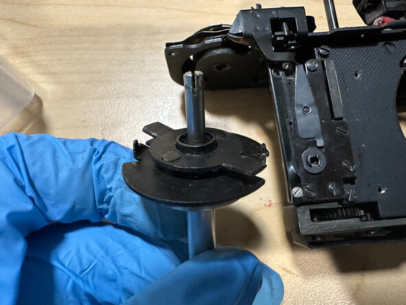

  7. Cleaning & lubricating a GOMZ Leningrad, Remove the winder spool: crwdns2935265:07crwdnd2935265:01crwdnd2935265:03crwdne2935265:0 Cleaning & lubricating a GOMZ Leningrad, Remove the winder spool: crwdns2935265:07crwdnd2935265:02crwdnd2935265:03crwdne2935265:0 Cleaning & lubricating a GOMZ Leningrad, Remove the winder spool: crwdns2935265:07crwdnd2935265:03crwdnd2935265:03crwdne2935265:0
    • With the chassis off, you may now take out the winder spool.
    • Study how the motor winder mechanism works.
    • The self timer mechanism is now accessible. If needed, remove the two screws securing it (red arrow) to service it.
