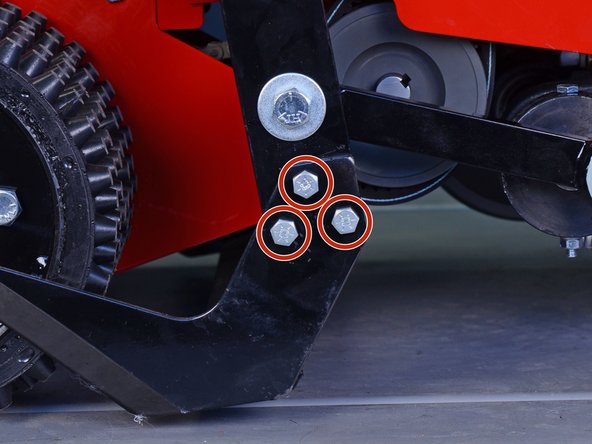

  3. Classen Sod Cutter SC18AHDCA 2019 Blade Replacement, Unscrew the blade: crwdns2935265:03crwdnd2935265:01crwdnd2935265:02crwdne2935265:0 Classen Sod Cutter SC18AHDCA 2019 Blade Replacement, Unscrew the blade: crwdns2935265:03crwdnd2935265:02crwdnd2935265:02crwdne2935265:0
    • Use a 1/2" socket wrench to remove the six 1 inch-long bolts securing both ends of the blade. You may need to use a 1/2" combination wrench to hold the nuts in place.

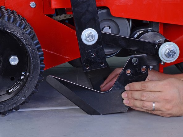

  4. Classen Sod Cutter SC18AHDCA 2019 Blade Replacement, Remove the blade: crwdns2935265:04crwdnd2935265:01crwdnd2935265:02crwdne2935265:0 Classen Sod Cutter SC18AHDCA 2019 Blade Replacement, Remove the blade: crwdns2935265:04crwdnd2935265:02crwdnd2935265:02crwdne2935265:0
    • The blade can be very sharp! Do not handle the blade from the cutting edge.
    • Grasp the back of the blade and slide it away from the mount.
    • Remove the blade.
