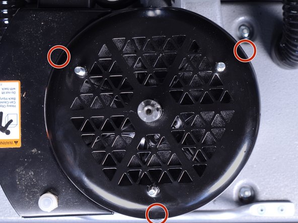

  14. Clarke Floor Sander 07014A 2012 Fan Cover Replacement, Fan Cover: crwdns2935265:014crwdnd2935265:01crwdnd2935265:02crwdne2935265:0 Clarke Floor Sander 07014A 2012 Fan Cover Replacement, Fan Cover: crwdns2935265:014crwdnd2935265:02crwdnd2935265:02crwdne2935265:0
    • Use a 3/16" hex key to remove the three 16 mm long bolts along the side of the fan cover.
    • These bolts have lock washers on them. Be sure to retain the washers for reinstallation.
  15. Clarke Floor Sander 07014A 2012 Fan Cover Replacement: crwdns2935265:015crwdnd2935265:01crwdnd2935265:02crwdne2935265:0 Clarke Floor Sander 07014A 2012 Fan Cover Replacement: crwdns2935265:015crwdnd2935265:02crwdnd2935265:02crwdne2935265:0
    • Lift the fan cover and remove it from the motor assembly.

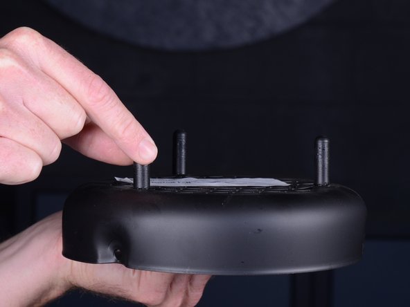

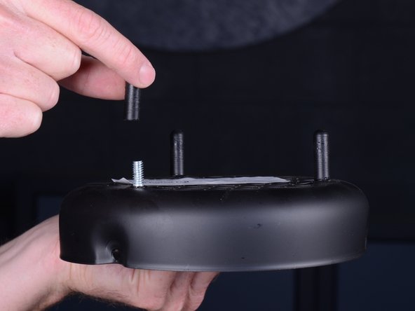

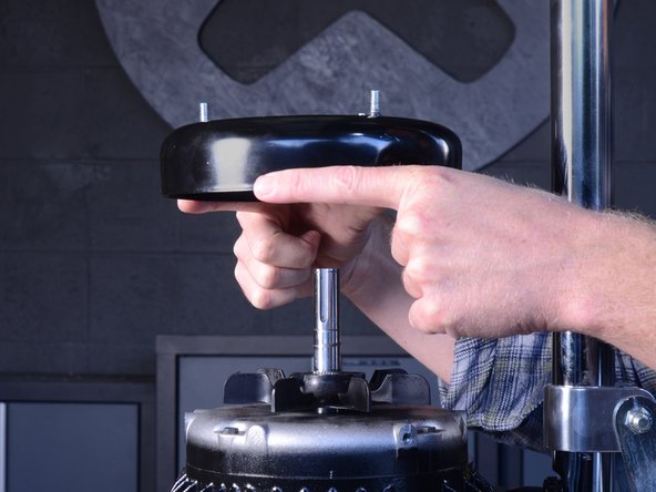

  16. Clarke Floor Sander 07014A 2012 Fan Cover Replacement: crwdns2935265:016crwdnd2935265:01crwdnd2935265:03crwdne2935265:0 Clarke Floor Sander 07014A 2012 Fan Cover Replacement: crwdns2935265:016crwdnd2935265:02crwdnd2935265:03crwdne2935265:0 Clarke Floor Sander 07014A 2012 Fan Cover Replacement: crwdns2935265:016crwdnd2935265:03crwdnd2935265:03crwdne2935265:0
    • Reassembly tips:
    • When you are installing the fan cover, note that the cover is not perfectly round. There is a slightly squared edge, which should sit close to the sander's handle.
    • Your replacement part will most likely have screw covers on the fan cover bolts. Be sure to remove them before installing the fan cover.
